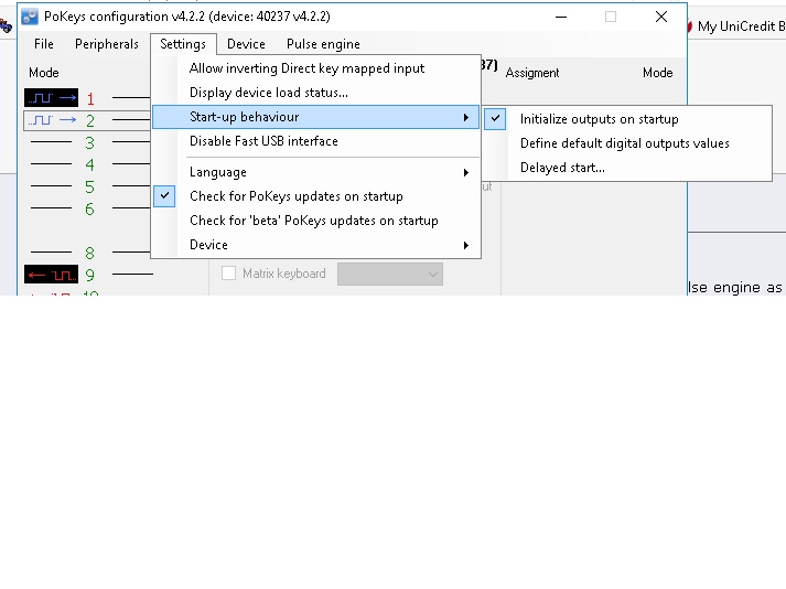

I configure PoKeys pin 2 as DigOut, shut down PoKeys, turn on Auggie+PoKeys and write some script turn Pin2 On/Off. All work good, but..
When I shut down Auggie+PoKeys and then wake it up, it does not work.
I open PoKeys, pin 2 has set DigOut. I repeat configure PoKeys pin 2 as DigOut. Shut down PoKeys and and turn on Auggie+PoKeys again. Auggie+PoKeys pin 2 works good again.
I repeat this several times and receive the same result. Where is my mistake?

I do not find pin7. But I fix the problem. I set Initialize output on start in Pokeys, see added picture. Now all pins work good.
Best regards,
Anatolii.
