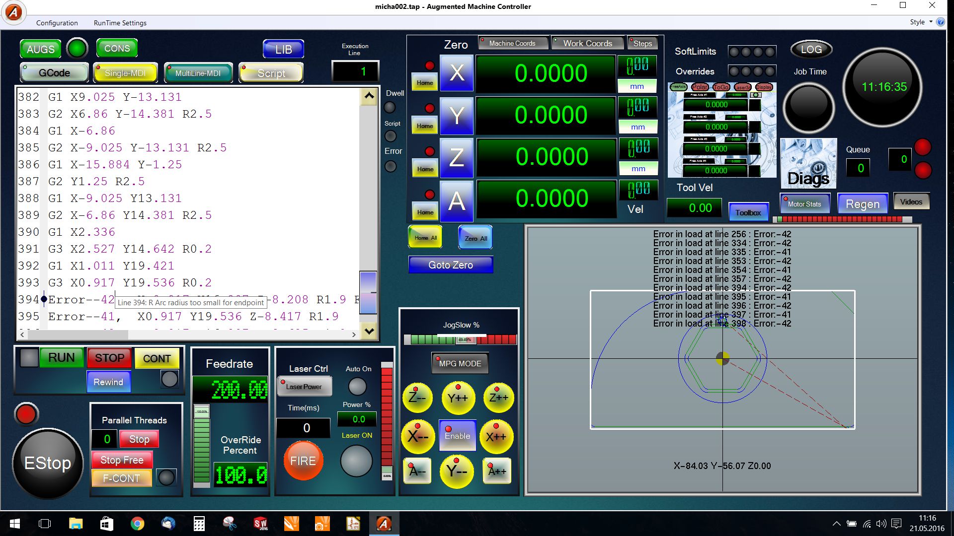

Hi all,
perhaps somebody could help me in my first steps:
I have build a simple geometry in Fusion 360. I used Mach 3 post processor. Now I get some error messages e.g. error 42 (means arc radius too small for endpoint). Changing the postprocessor to genric fanuc or teensy I get some other errors, e.g overspeed. Attached is the gcode file for mach 3 post processor and a screen shot.
Can anyone help me for my first cnc cut?
MOD: I found the radius problem to be a ramping issueso I changed that, but now I have the issue of overspeed at G0 commands. I changed manually G= to G1, this helped in one line, but now in others.

Here are some "not working" examples ...
I tried to send them some minutes ago ... but not all files are allowed ... so now as zip
In Auggie I get at some lines an Estop ... (Log: Overspeed)
In Mach3 I get strange circles, but I can see the part as preview
In Estlcam I get also starnage huge circles ....
I used different post processors in Fusion, but nothing changed.
- notworkinggcode.zip
- (38.54 KiB) Downloaded 410 times
Regards Michael
Re: Errors in GCode, Question from Newbee
Michael:
Redownload the dev version, version numbers are the same, but I just updated for this problem.
The R arcs are .1% off their center, so I made Auggie accept it up to 1% off.
They should now run, they do here.
