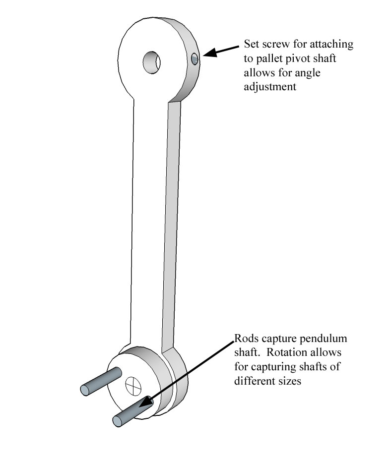

Here is a versatile crutch design for those experimenting with escapements.  It allows for angle adjustments using a set screw in the pallet shaft boss, and the push rod width can be adjusted by rotating the hub to accommodate different sized pendulum shafts.  Disclaimer - I haven't actually built one of these yet but I will soon and let you know how it works.

Great ..simple.. as it should be..
