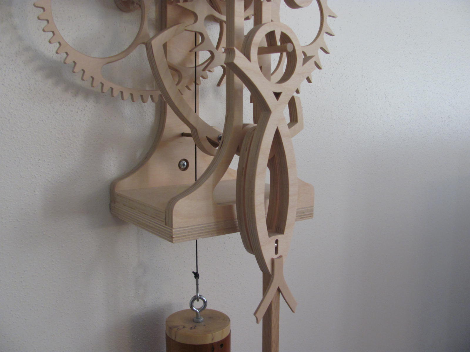

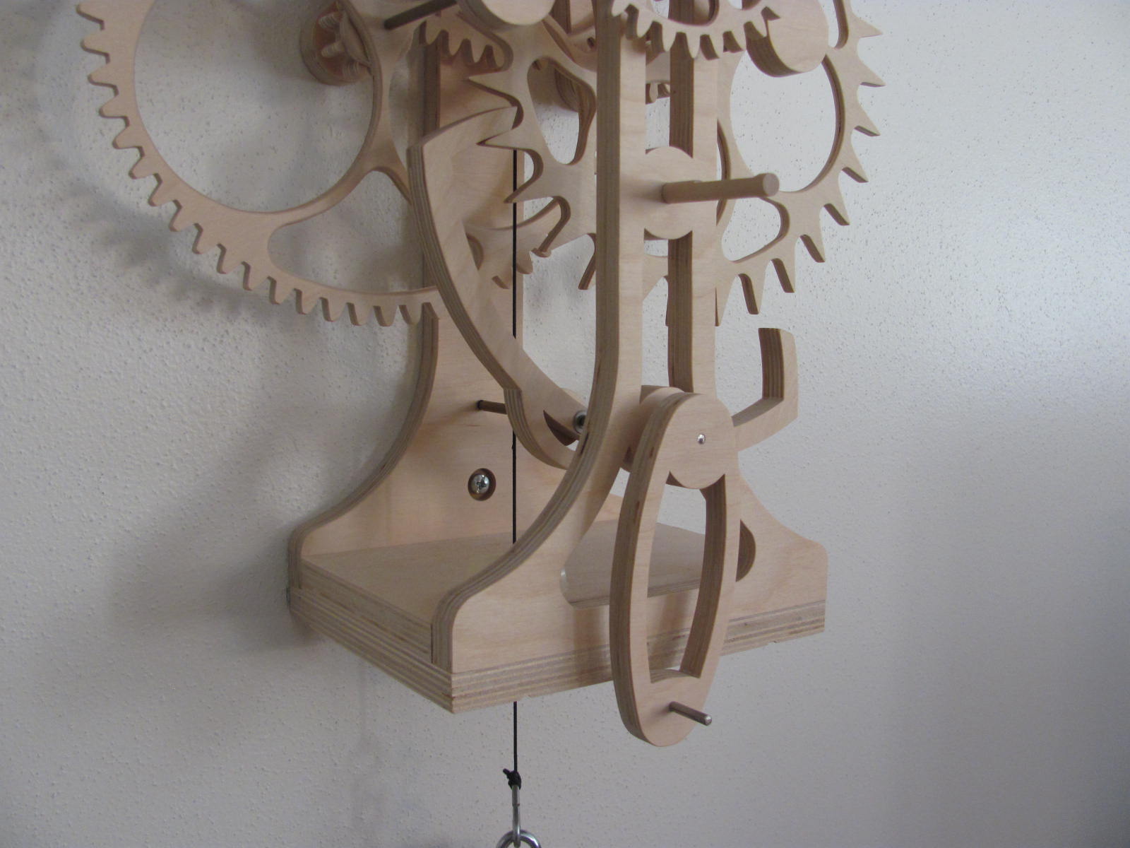

Re: Looking for advise from clock bilders
Don:
Here are a couple of photos showing the pendulum-crutch arrangement that Art mentioned. In this case (Clayton Boyer's Clock #6), the crutch is attached to the pallet shaft and is a tight fit so it's adjustable. The pin extending from the crutch goes through a slot in the pendulum with only about .010" slop between the slot and pin. The driving force on the escape wheel rubs against the pallet faces and gives a tiny push to the crutch pin with each beat, thereby keeping the pendulum going. A lot of new clock builders think that the pendulum drives the escape wheel when, in fact, it's the other way around. I highly recommend that you purchase a proven design plan and build it. Consider the money spent as tuition on learning how all the parts go together.
Mark
Mark
Mark:
That IS truly nice work, makes me want to drop everything and build another clock. :)
