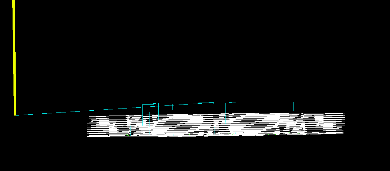

I make a gear in Gearotic, I post it and send it to Carbide Motion, 1/2 the time I cannot get the
end mill to start at the exact height of the material. I have tried tons of settings.
Other times it starts off okay, then in the middle the whole thing turns to shit.
I have tried to do a tool path in Meshcam, in the software everything looks perfect
then some other type of issue.
