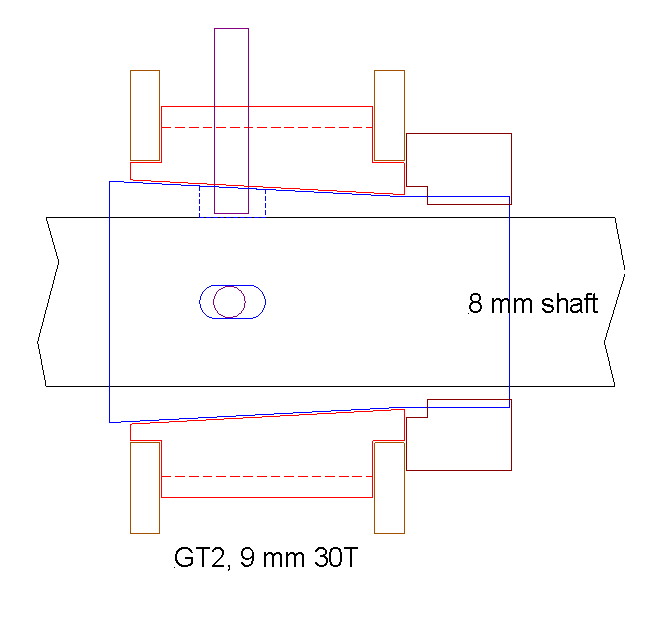

This is a 30T GT2 pulley for a 9 mm wide belt, with taperlock, on an 8 mm shaft.
The brown bit on the right is a M12x1 mm nut which tightens it up. Yes, the taperlock has to have a split.
The vertical rod in the middle needs some explaining. When you try to tighten the nut, there is a bit more friction between the nut and the taperlock fitting than between the taperlock and the pulley. So the taperlock spins and the nut never tightens. This is normally solved with a bit of key steel, but try doing that at these dimensions! (I did try, but the results were not good enough.)
Instead the purple rod goes through the pulley and into a key slot in the taperlock: two views are given. This stops any rotation. Once the nut is fairly tight you don't need the rod any more, so it is removed.
Photos of completed unit to follow in a day or two: I am still machining the GT2 teeth on these pulleys. I have made other GT2 pulleys but they are in use, and they had bolted flanges instead.

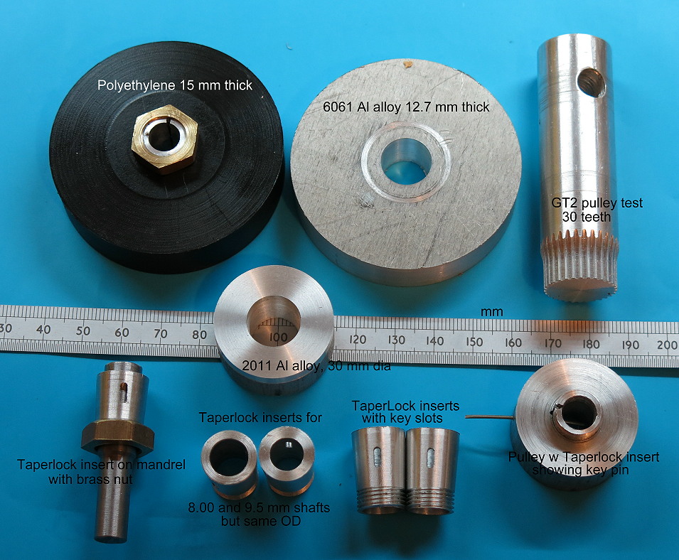

Photo as promised below. From top downwards:
Two large pulley blanks, one in PE and one in 6061. I KNOW the PE is not as strong as the 6061, but the diameter is 3x that of the smaller 6061 pulley, and I know the teeth on that size are strong enough. I know that nylon, in quite thin sections, is often used for toothed belt pulleys. So - an experiment. I suspect the teeth on the PE pulley will turn out excellent.
The PE blank has a taperlock unit in it, with brass nut. The big Q is whether the taperlock will hold against the PE, or whether it might slip. I don't know yet. I don't think cracking is a worry with industrial PE this thick. If it does slip I can put an Al bush insert into the PE with flange screws: commercial nylon pulleys have Al bushes and the nylon is molded around the bush.
Test GT2 pulley, 30T. Just one of a number of GT2 pulleys I have made. The others are actually in use. My cutter (which I made) may deviate from the official GT2 profile by a micron or two, but should I worry about a few microns when the belt face is fabric?
2011 Al alloy pulley in middle. There will be a 3:1 ratio between the big and small pulleys when they are finished. Yes, the bore in these blanks is tapered already: 3 degrees half angle.
TL insert on mandrel. It has 8.00 and 9.50 mm ends.
Taperlock inserts for 8.0 and 9.5 mm shafts: you can see the slightly different wall thicknesses.
TL inserts showing anti-rotation key slots used only when tightening the fitting
Pulley showing pin going through plulley into TL insert. (In this unit the key slot overlays the split, which has been hacked around a bit during experiments.)
Still to do: turn the ODs of the blanks down to correct values; cut GT2 teeth onto blanks; make up side flanges and fit to pulleys; fit and test.
