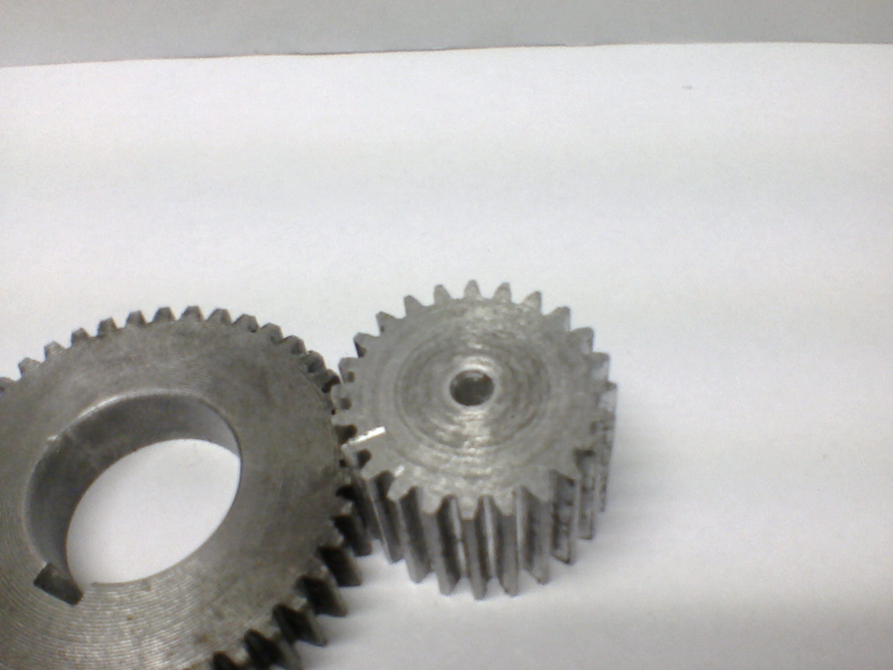

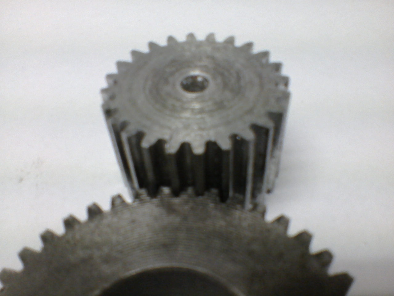

thanks art, though... i sorta went ahead and did it anyway...
no cussing :)
no shattered bits of tool steel...
next time, i shall measure my blank first, rather than just grab whatever is handy and guess it wants 24 teeth... i was right, it did :D give or take half a mm. i had to jog in on the Y about 0.45 to get the depth right.
what sets the travel in the X? i know width sets the blank width, but it seems a bit of overkill, moving the tool about 70mm for a 15 mm blank. it tried hitting my chuck jaws! is it simply due to the diameter of the saw? if so, i live with it...
my only lament now is... bring on the eccentric gear shaving! :) that and the roots blower!
Re: about to start...zero help?
Looks good as a result. :)
  Normally width is a setting not for blank width, but for the amount of X travel.
The distance you have is necessary so the blank clears before rotation, However,
as of last year you can also select "Reverse Tangent", this is handy for a saw as you
can narrow a lot the width as the saw will pull out all the way between flanks.
  This can save you a lot of distance and time. :)
(Nice work, the involutes look good)...
