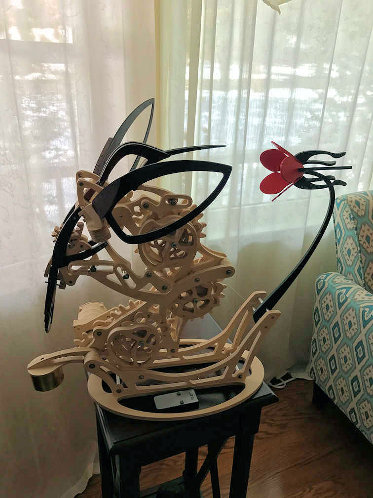

Hi folks,
Just joined the forum and while browsing I came across this thread regarding the Colibri Hummingbird sculpture.
I built one several months ago (picture attached) and it's a real show-stopper when people come to visit. I added an electric motor drive and it really works well.
With over 400 parts, it takes some time to build but I found the plans to be excellent. The .dxf files for all wood parts are also provided with the plans.
I found the designer, Derek Hugger, to be extremely helpful during my build and very promptly answered any questions that came up.
I'd like to try my hand at designing a kinetic sculpture and I'm sure Gearotic 3.0 will make the project easier to design and visualize.
Kevin
