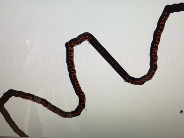

I was thinking of reducing the number of nodes as I was cutting this in plastic with a laser. As you can see in this attached picture I manually reduced the number of nodes on one side of the gear. The problem with so many nodes it is difficult to fine tune the cutting speed and get a clean edge. I am just playing with all the available options for now.
Kim
Kim

Ahh, an epilog,generally the best one out there. Nice machine. I think your going about it right, play
around with all settings you can find till you find one to smooth it out. The nodes in Gearotic if reduced
much more than default will take away from the curvature, Id try to see if you can find a way to tell Corel
to bezier the curve, that should speed it up Id think..
