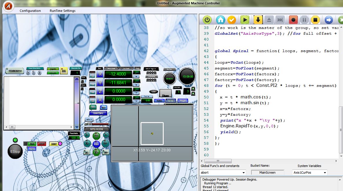

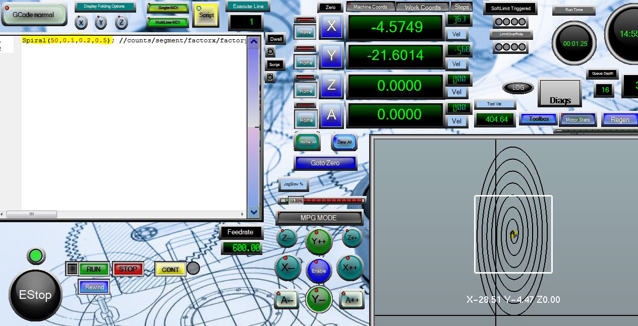

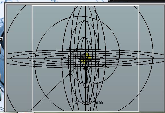

Here is a down and dirty function, that can create a spiral with some control of shape and size.
called from the script box passing the variables to it.
Makes all that gcode obsolete/waste of time to do something this simple :D
Art will have videos of how to do all this in time but I wanted to show where the main scripts was and how I accessed it.
You might have to use "Configuration/Screen Tools/Fill Screen" at times as I find sometimes it don't resize on its own.
Code: Select all
global Spiral = function( loops, segment, factorX, factorY )
loops=ToInt(loops);
segment=ToFloat(segment);
factorX=ToFloat(factorX);
factorY=ToFloat(factorY);
	for (t = 0; t < Const.PI2 * loops; t += segment)
		x = t * math.cos(t);
		y = t * math.sin(t);
		x=x*factorX;
		y=y*factorY;
		print("x "+x + "\ty "+y); //this gets outputted to the Log file. Access with a button push on button labeled "Log"
		Engine.RapidTo(x,y,0,0); //actual movement in x,y,z,a
		yield(); //give it an out to look whats going on elsewhere.

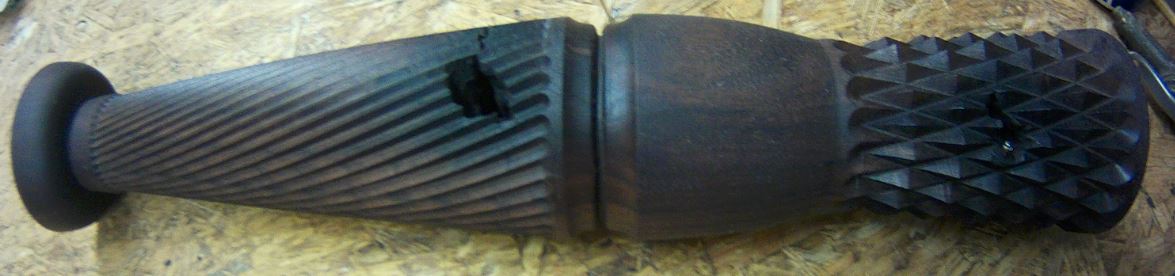

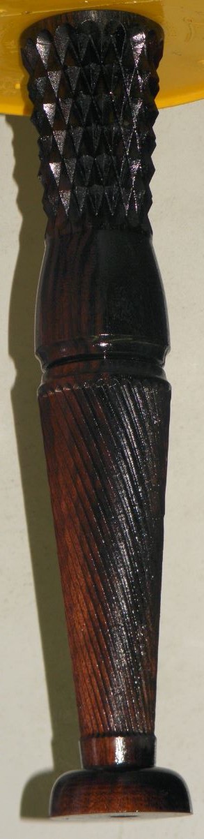

Don't expect to pick this up quick, We all learn at our own pace and somethings flow at time and other times NOT that when I just yell out "ART!" and shake my head. It will start to click just like gcode, basic, subroutines did in time. Dont give up, build a community and share your functions or your need for one. We all can help and learn from each other.
here is an example of my last Gcode using pretty much all variables to make the attached photo's hatching patterns.
(And no it will not run in Auggie due to the pound variables, just an example for those that like the obscure)
just a couple of changes to the variables and I was cutting. It took me years to get to that ability. And pretty much the only way I program anymore. I have routines for turning, boring, facing, threading I just change a few variables touch off the needed locations and hit RUN.
I HATE GCODE. &nbsp;::) &nbsp;but, I love tools, and scripting is a great tool to learn to use.
I would love to beable to do something like that with an Auggie function
So im just learning too.
Art loved to punish me till we found what worked. Been quite a journey to get to this point. &nbsp; :-X

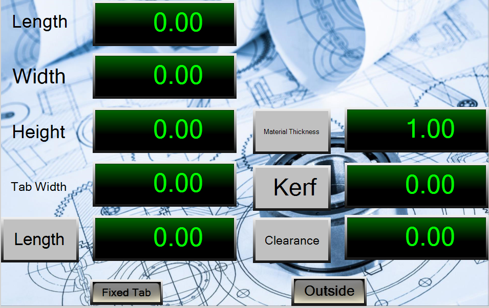

I was thinking for my first attempt, I was going to adapt some python code to create a tabbed box.
These examples will go along way to help.
Glenn

Photo does not do it justice, I'm sure Mom (96) will enjoy it.
thanks again guys

So I have it doing a actual squares block("MotionStill"); now instead of a squares with radiused corners.
Ya-Nvr-No's code examples in the are very helpful. Thank you!
