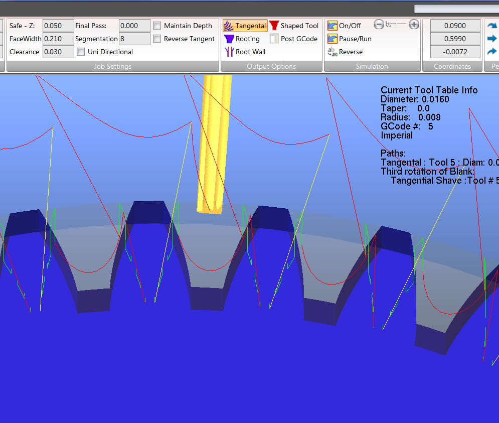

I have let this slide for quite some time but have finally got to the point where I'm ready to cut the gear, blank turned & on the mandrill. Set up the gear in 4th axis enter the .016" endmill in the tool box which is smaller than the .0176 minimum size required and get a message saying the cutter is to large, why? I tried different thing like changing the stepover, depth of cut, nothing changes. I'm doing a 48 tooth 20DP gear. I updated to V2.3005 and still get the visual of the tangental cut in the middle of the gear but as I understand that's just graphics and doesn't cut that way. Any suggestions for the cutter to large message?

When I hit the root wall button it's fine. If I hit Rooting I'm given the message"To many passes, diameter of bit to small for rooting" I do have the doc set at .005. When I hit Tangental "Tool appears to large for operation? Please check tool size carefully?" I will try to change to the 49 tooth tomorrow, and see if that works.

Ok I reran everything, 24tooth, 48tooth, 49tooth as you suggested and all three do the same thing that being cutting in the middle of the image of the tooth. I realize that my cutter is .016 and the called out minimum is .0176does this mean my maximum stepover should be .0008? so that its not oversized on the bottom of the tooth?

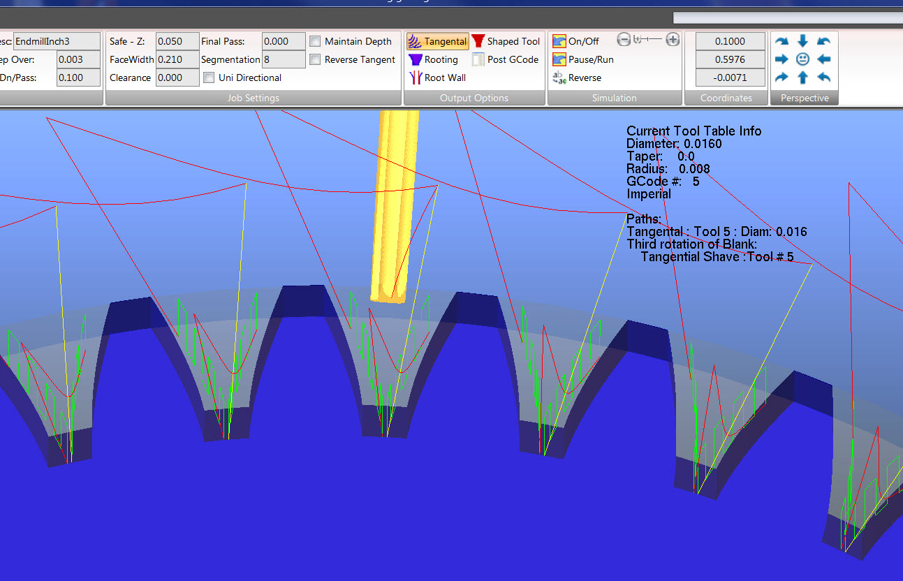

Here's the file. I hope that it's not some rookie mistake.

Hi Art:
Heres the project file after I fixed it. It sends to 4th axis and displays properly now.
The only thing I really found was no master was set, for some reason the way you had it linked caused
a mesh issue, Im not sure exactly why. So first, I selected your large wheel, and right clicked and "send to design", this allowed me to regenerate it. I added it to the screen on the small gear where it meshed, but if I then tried to move it by using "Move on gear" , it woudl move, but went out of mesh.. strange. I then noticed there was no master. SO I selected the small pinion, right click - "Set as Master" , and suddenly they worked fine. I selected the lareg one, send to 4th axis, made a .017 tool and could see its a tight squeek in the root, so any error you get really isnt important, it simulated well.
Anyway, give it a shot, or just download this one. :)

Just so we don't get confused over terminology, it looks to me like we are discussing two issues,
1) A graphics issue where the tool appears in the center of a tooth so its hard to see if its cutting properly, and
2) Whether the tool is too large or not.
on 1), I cant seem to repeat this so long as a gear is selected as driver. If I then send one of the gears to the
4th axis for machining, the tool is starting dead center in the tooth space on mine. Is this the case on yours now or
is the tool in the middle of the tooth still?
on 2), the tool I tested with at .017 seems to Just Fit.. not much room , but seems to be able to do the job.
Which of the two are we talking about when you say the tangentals are in the tooth. Its the nature of the system that if rooting is properly starting in center of tooth space then tangental must as well, so are you saying rooting looks good, but
tangental is being pushed into the tooth as opposed to starting in center of it? As if the tool is too large?
