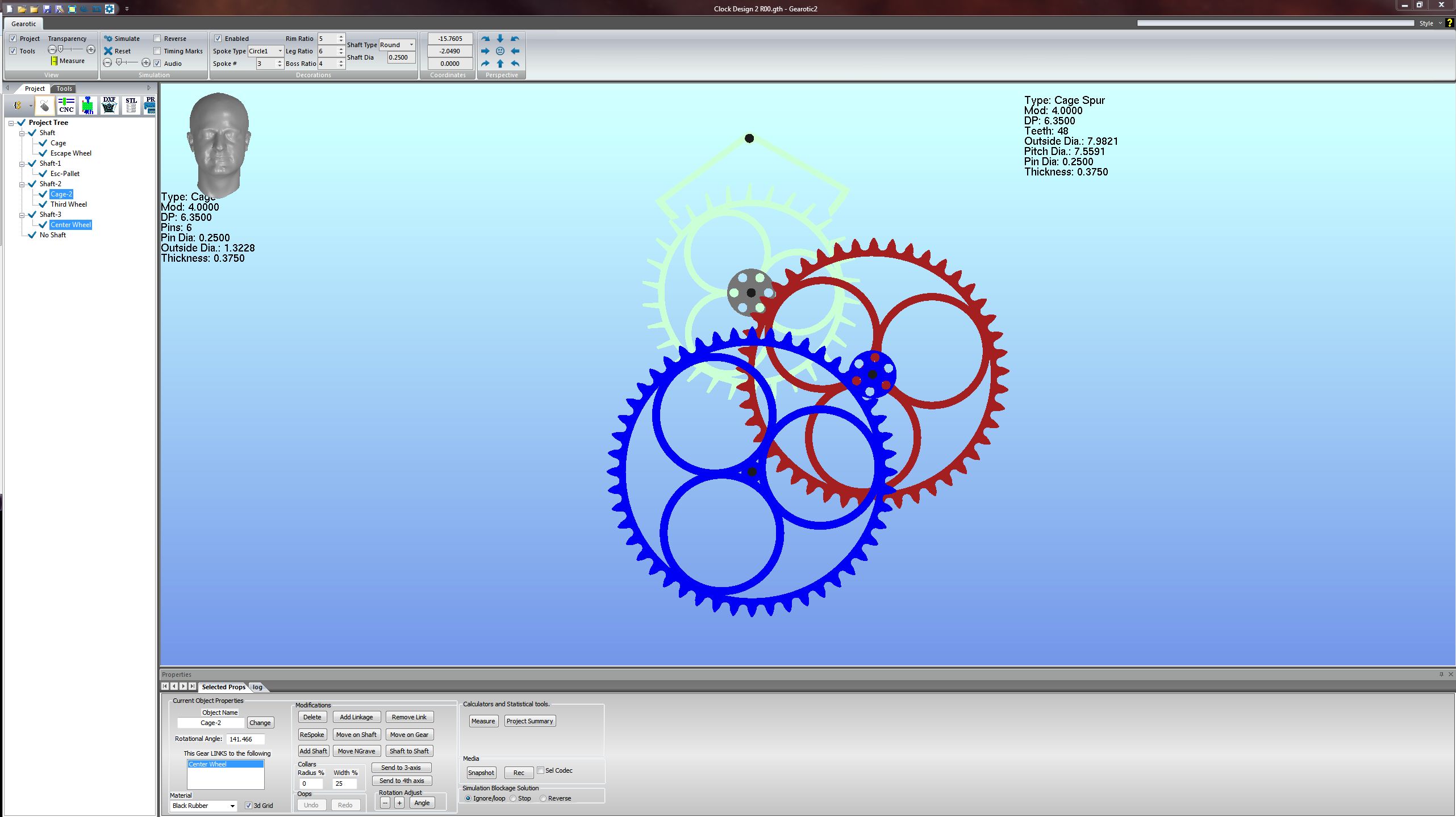

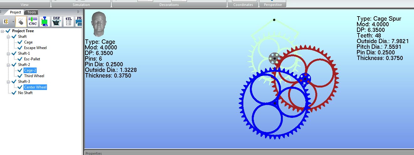

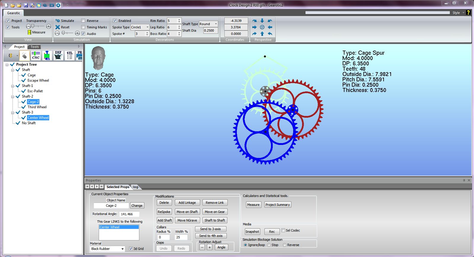

Hi Art and thanks for the quick response.
I thought that would be the case, but that's not showing up on my screen anywhere that I can see. See attached:
Re: Shaft Center to Center Distances
Hi Bent..
ouch, I see that. Try pulling down the properties window, ( grab the top lip of the window and pull down.. Im wondering if
its just too low. Ill look into it meanwhile.)
Jeff;
Is your monitor set to a lower res? I'm wondering if that has something to do with you not seeing the window tab on top. In the past I had a few customers with similar problems, turned out by adjusting their screen resolution fixed it, however I agree with Art with this one, try moving it down first see if that helps any.
- Posts: 7
- Joined: Thu Nov 26, 2015 12:50 pm
Gents;
That screen shot i posted was only a partial clip. I've attached the full screen (less the Windows taskbar) below. The res on my laptop is 1600 x 900. I have a secondary monitor at 2560 x 1440, but placing Gearotic on there doesn't make a difference in this case (although the work area gets huge and the text quite small).
Jeff
Jeff
