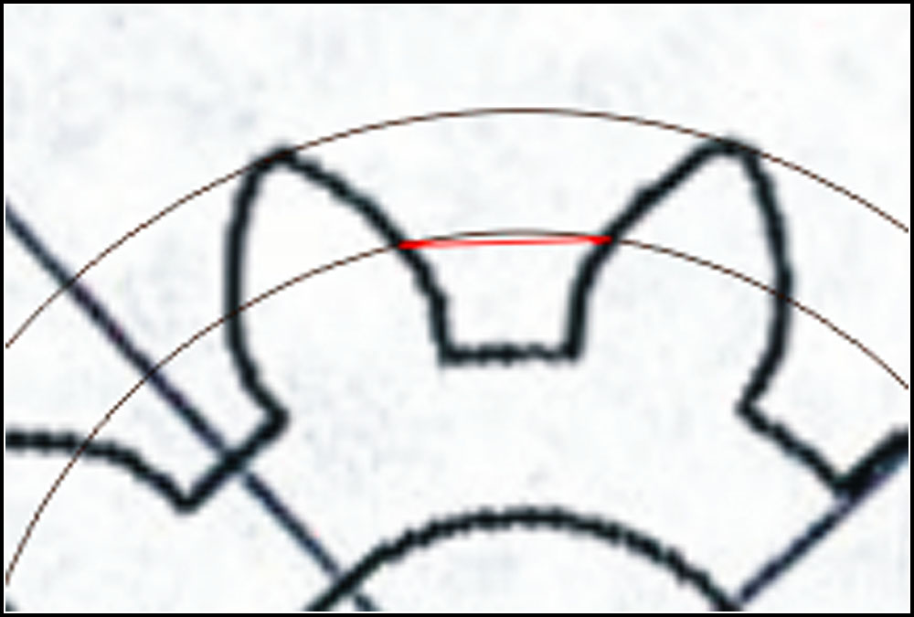

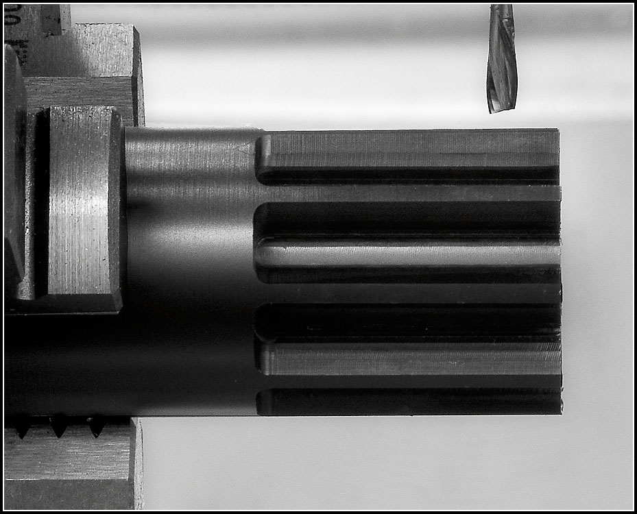

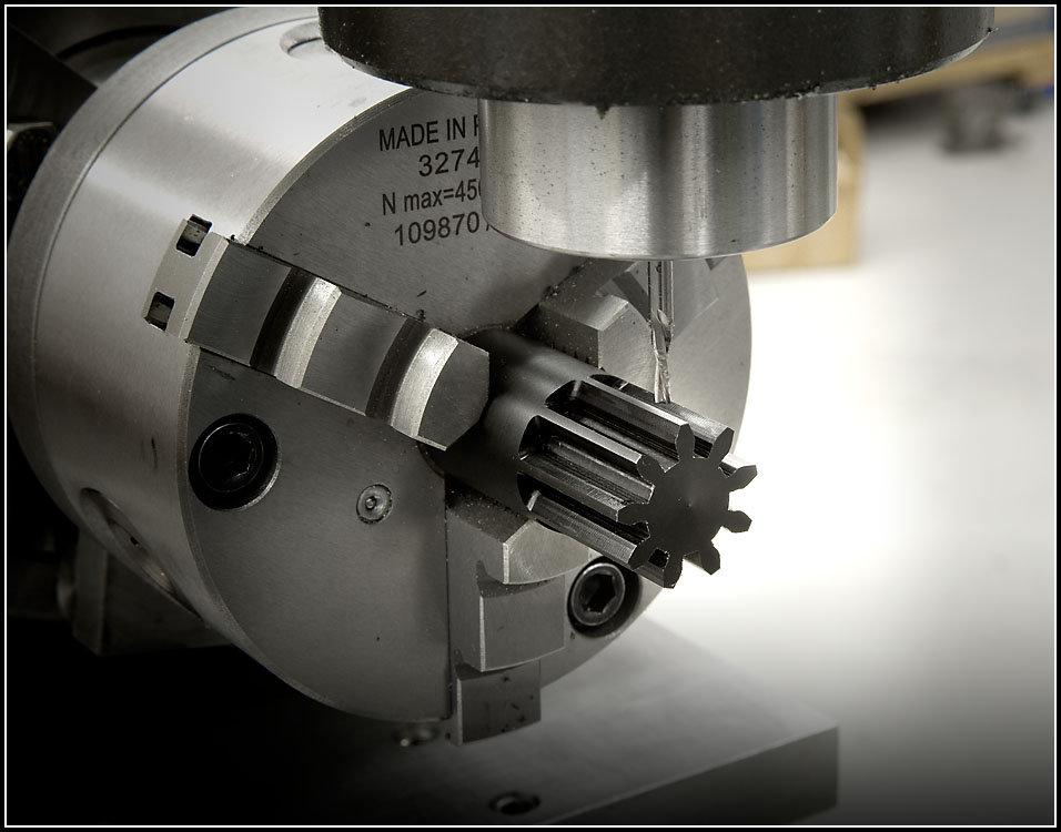

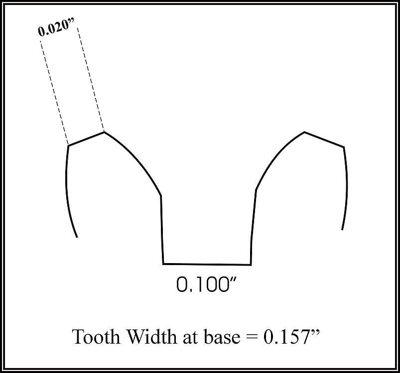

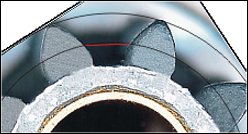

Good morning guys. Art, I will respond to your last post shortly. I want to show you the results of my endeavors. Am including 3 images.
Harold
Harold
Re: Problem Encountered; need advise
HI Harold:
Not bad..but I think your reporting the tool as a bit smaller than it is. Id tell the program its diamter is about 5% larger. The teeth are too narrow I think.. ( Unless thats on purpose, like you used .45 or something for width. It looks like a half decent 14.5PA gear otherwise , just a bit thin in the tooth, and due to the undercut the root wall routine couldnt clean up the root real well, wont matter in those delrins though.

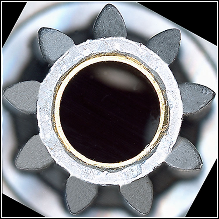

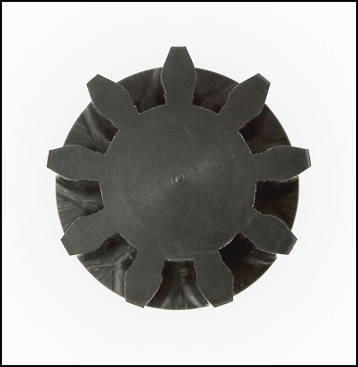

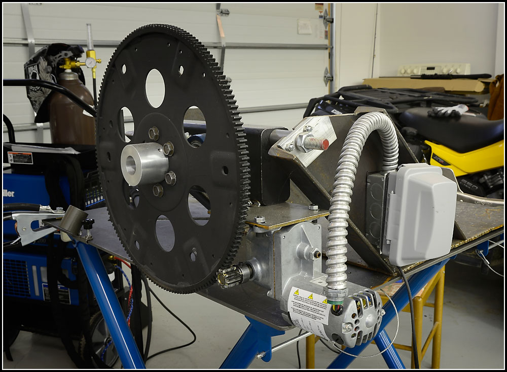

Art, it would be likely helpful to explain what I am doing and to show a couple of images.
Originally, I began by fabricating a heavy duty rotisserie that would support a whole pig and that includes 12 to 14 hours of non-stop turning-time over a fire. The motor is a Dayton (AC/DC) gear reduction motor (RPM 6.7, torque 162 in/lbs). The large wheel is a fly wheel from a 1985 Chev, 350 cu in engine, and the pinion gear on the Dayton motor is one that was originally designed to fit a starter motor and turn the engine?s fly wheel when starting the engine. This has worked quite well.
Next I decided to make the rotisserie device a ?double duty? contraption by turning it into a welding positioner that would slowly rotate a round part while I am welding (TIG, MIG, Spool, or Stick). I reasoned that if the rotisserie would easily support a hog, then it would surely support, say, a 4? piece of thin-wall-tubing that?s no longer than 12 inches.
The problem with which I?m faced is, the pinion and wheel are metal thus arcing between the gear?s teeth would likely occur when welding. Additionally, since the bearings are also metal, this too would create an electrical potential for arcing and welding together. Too, the motor needs to be isolated from the electrical welding circuit.
I needed a way to isolate and eliminate all electrical potentials so I decided to isolate the motor by using a Delrin pinion gear, as well as a plate of phenolic material between the motor?s metal base and the positioner with further isolation via phenolic spacers through the holes where the bolts secure the reduction motor. Additionally, I have chosen to remove the bearings (x2) and replace the bearings with Delrin bushings. Placing electrical brushes in close proximity to the part being secured in the chuck, I believe this will significantly reduce electrical potentials throughout the positioner?s frame.
Fabricating a new fly-wheel to match the pinion is not an option. I think the fly-wheel has somewhere around 134 teeth. Since the motor turns soooo slowly, and the fact that the weight of the tubing being welded is so slight, I will get quite a few miles of service from the Delrin gear.
In passing, I used gear-pitch gages (20 and 14.5 PA) to *initially* determine the PA and DP followed by careful measurements and math to corroborate the determined PA and DP.
Since the pinion gear is sintered, I assume the gear is proprietary and not a standard gear.
I am including a frontal view of the original pinion gear and an image of the rotisserie/positioner. One can easily see that *form* of the original gear is significantly different than the one I fabricated.
Finally, the Delrin gear seems to nicely articulate with the ?wheel? so I am in hopes this attempt will work. The proof is in the pudding.
Harold
Harold
HI Harold:
Yeah, I think youll be fine. Definitely a special gear, looks like a 30PA with a profile shift of -.5
But I think your fine.. that type of application should be fine with that gear. Congrats..
Will this do you Harold ?
Ticks all your boxes and looks like the original.
You need a shift of 0.6 and 0.6 on the width.
