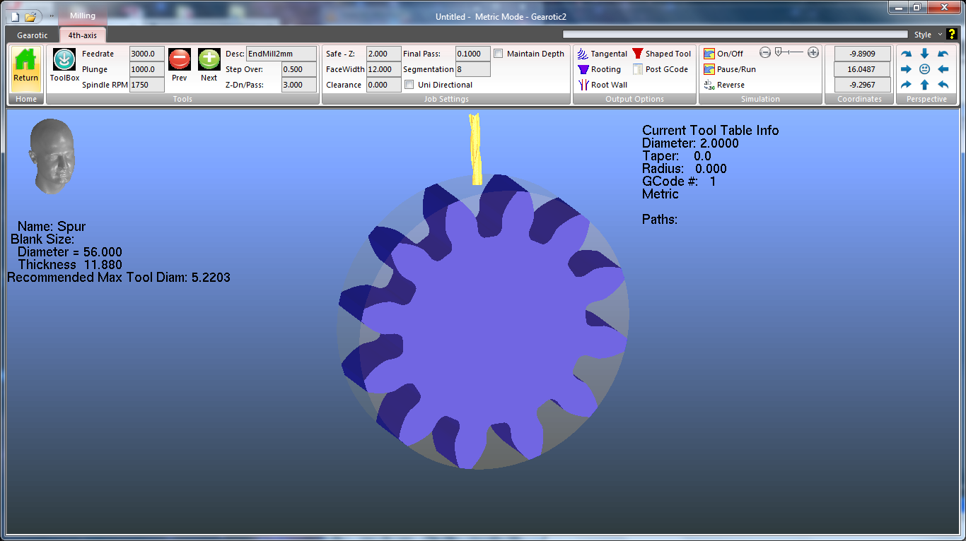

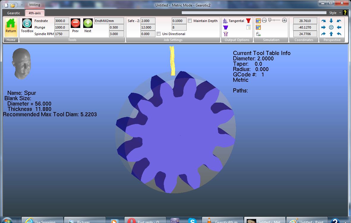

err..mystery sorta solved...
It looks ok maximized
but
if I partially minimize the laptop screen -- the menu boxes do not re-size the menu texts
but simply "clip" the menu texts.
I have also attached 2x screen dumps of the referred screen.
rgds
Charles
Win7 Sp1
but
rgds
Charles
Re: Gearotic 2.2981
oops finger trouble..
and attached is the working maximized screen.
Charles
Charles
Re: Gearotic 2.2981
Hi Charles:
Thx, this is a klnown problem, if shrunk too much some menu's disappear, Gearotic assumes a minimum resolution.
I hope to make that better this year..its due to technicalissues in the libraries..
