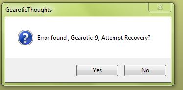

Hi Art:
I get a popup that says, "Error found, Gearotic 9, Attempt Recovery?"
Yes does nothing except blink the popup. No closes Gearotic.
Any idea what I can do?

Hi Art:
I tried 2.29700 and I got Error 93.
Clicking on "Yes" gave me Error 1167.
Further clicks on "Yes" brought me right back to Error 1197.
Clicking "No" crashed the program.
Thanks!
