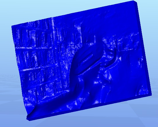

Seriously amazing! Great timing, the Lifecam Cinema was here when I got home from shop class last night.
Not enough coffee yet for a selfie, so grabbed a random gear toy (this is Gearotic; cage gear from GM) from the shelf in the Moosecave, and gave it a shot. My aging AMD quadcore was plenty fast at 640x480 so left it there.
Did a good job on the books in the background; might need to use backdrop, or set up the mini photobooth if you care what's behind.
