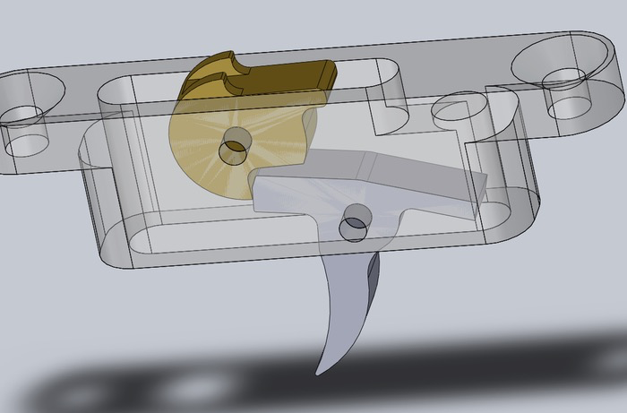

Here's an idea for a release.
As a teenager I made an 80 pound pull crossbow.  The trigger mechanism was really simple and worked flawlessly for me.  It would seem to me that a variation on this idea would easily work for one ball or for 12 as there is very little force to activate the mechanism.
Just and idea.

I have that picture now saved as reference. Thanks for the pic; that concept might work nicely. I'm still studying levers of different sorts to see what might work best. I hope to still have pics of progress within the week.
