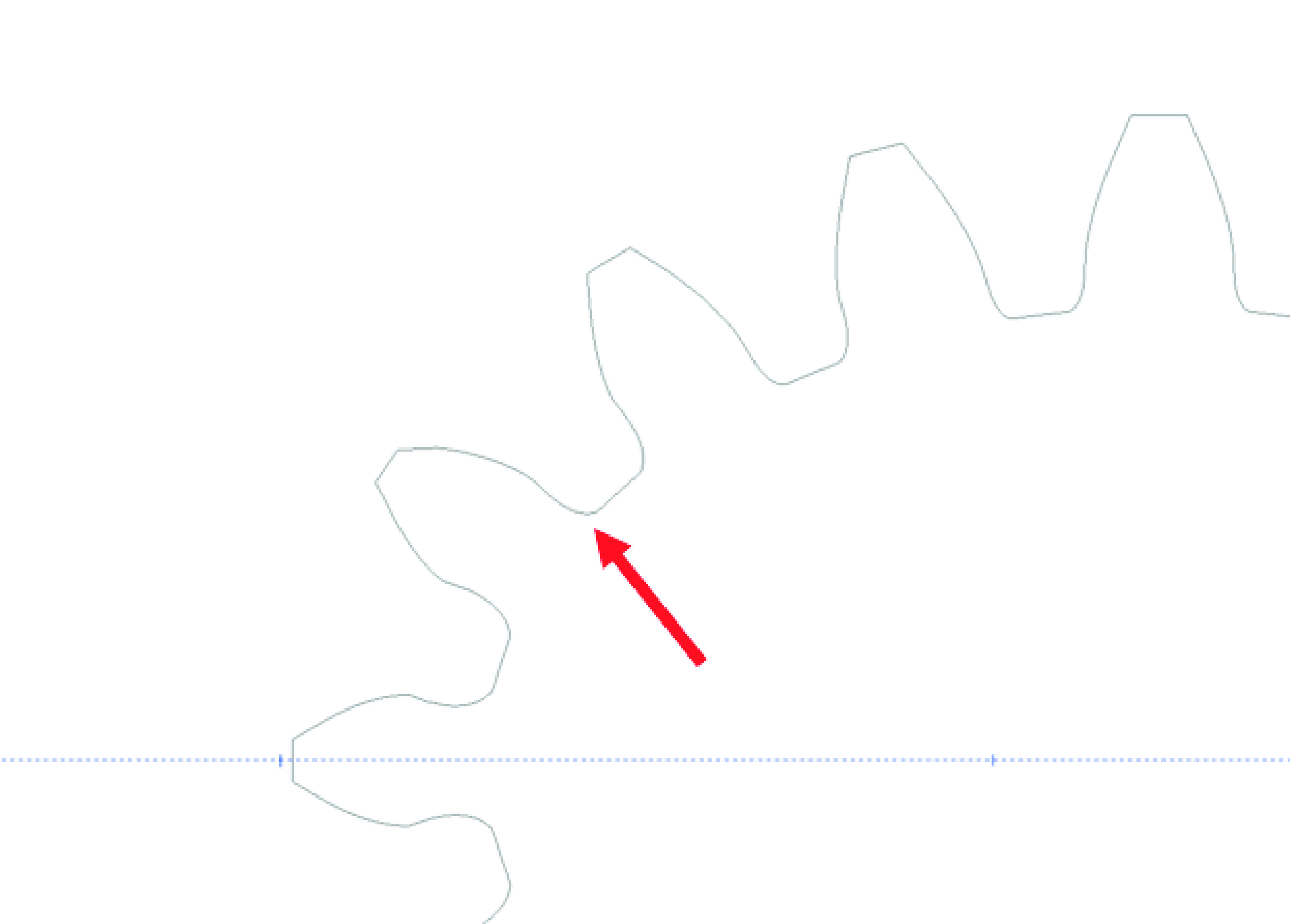

Thanks for the Antialiasing update.
Although, the tooth path is superior to non-antialiasing, there are still some jagies.

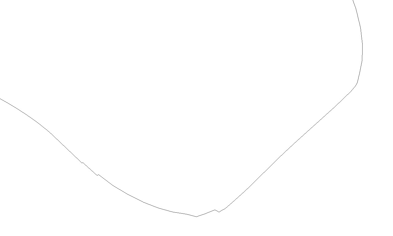

Re: Version 2.290 online.
Yes, its dual triangle detector, so it can miss some jaggies. Hard to tell how bad it is from your photos, if I load
youir dxf into Vectric and select a node-edit, so I can see each point, it shows no reversals where your photo seems to show
reversals that I dont think exist.. though there are definitely a few small divots in it.
I will continue to work on that part of the system to see what can be done to make it better, on the bright side, it is
99% cleaner than last week. :)

I have attached a jpg showing the location of the jagies. The jagies are located at the 10 o'clock position.
Gary
Gary
Gary:
Yes , I see them. Ill see if I can tighten the filter any.

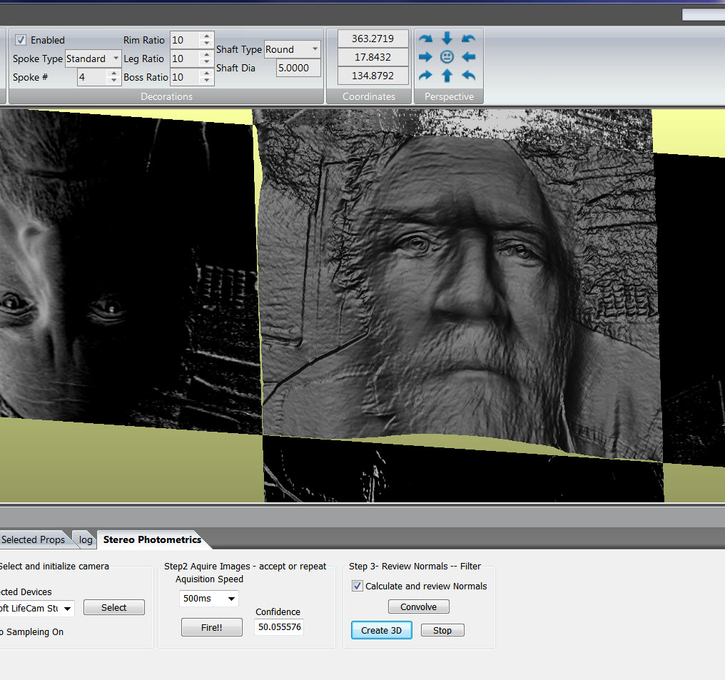

Im playing with web camera->3d image techniques.. Dunno if it will ever make it into a release, but heres a small initial test... Just webcam..monitor and time..
Hi Steve:
You may have trouble getting the cats and dogs to sit still... lol
I have researched this type of technology because of personal interest, Im amazed there arent more
of them out there to play with. There are a few papers describing how to do it , though I have only begun
to play in this, so my code is pretty slow. It does require a live subject though , the webcam takes 3 shots quickly
with the monitor playing a pattern. so the object has to stay still for at least 0.25 seconds or so.. and up to 1 second
for some webcams..
It will be added to gearotic if it proves itself usefull.... hard to say though, this is all finicky stuf...
for some webcams..
