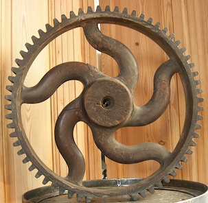

Is there a tutorial (video or text) that shows how to create custom spokes?
I know the dxf files are in C:\Gearotic Motion\Spokes and I've tried editing them with various fee CAD programs like DoubleCAD XT 5. But the end result is a spoke that does not look correct. Instead of figuring out what I'm doing wrong, I thought it might be good to start clean and learn the correct way to create custom spokes.
My end goal is to make a swoopy spoke similar to the attached picture.

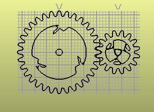

I created the attached. I've set 0,0 to center of vector. At least one of the examples in ..\spokes\ has the machine start at lower left but 0,0 appears to be in the center of the drawing. Don't know about clockwise or not. The scale appears to me to be pretty much what I see in the examples. Otherwise, I am unable to discern any differences which would prevent this dxf from being properly treated as an acceptable (other than aesthetics, perhaps) spoke.
I CAN and will wait until the next release if some of the changes you made will reduce the parameters I need to control (i.e., Gearotic will take care of more than presently in importing dxf spokes). thanks.
Brian.
still having fun.
Re: Custom Spokes
Brian:
I forgot a rule.. each spoke should be 102 units tall. This allows it to be scaled without me checking for size..
Change yours to += 52 in the Y and it loads..
It uses from +50 to -50, the rest is so it hooks into the boss and the rim...

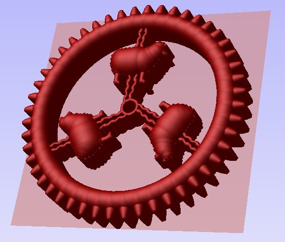

Please see rendering attached. I like the ability to tilt the angle of the spoke into the rim and shaft. The wooden gears worked out well, but are not practical -- would need to thicken the tabs.
Thanks, again.
Thanks, again.
