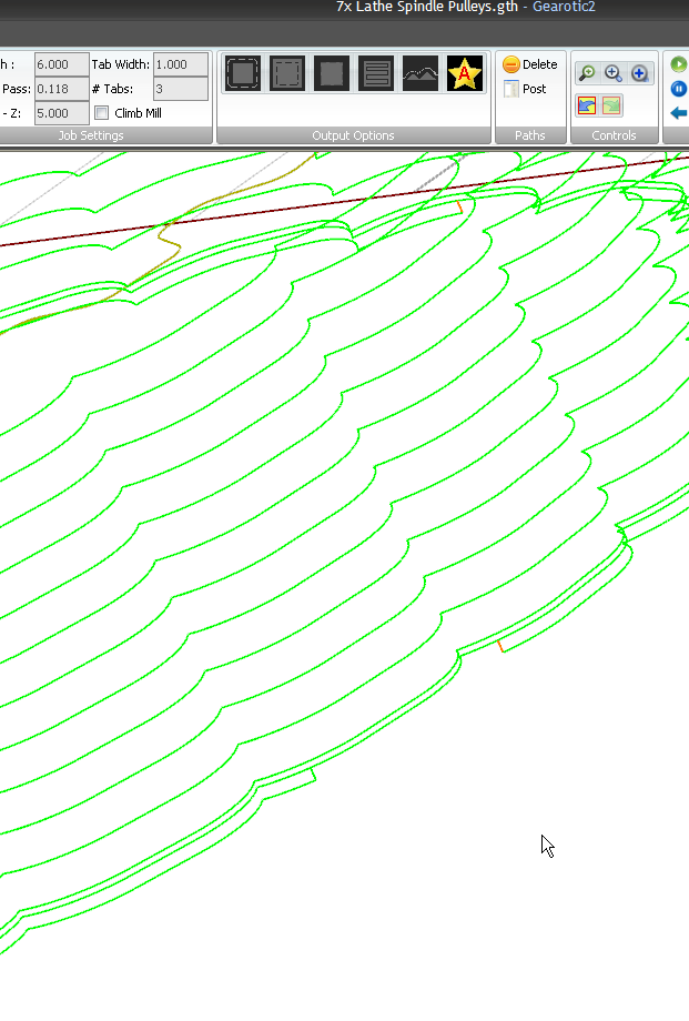

I'm familiar with Aspire's tabs so I am probably not understanding your method of doing tabs. I tried changing a couple of items but no luck. I really admire your creativity Art, thanks for all you've done. I think I attached the project.
Re: 3-Axis CNC Tabs feature
Your tabs are therew. their just small. The tabs exist from final pass depth to full depth
at the width you requested. If I tilt your toolpath and look I can see them. ( Look at the bottom of this graphics..
youll notice the tab..)
