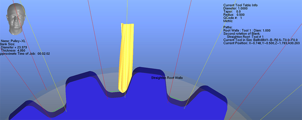

Re: Version 2.279 online
Aa-and I ran into another possible issue. Pulleys and root wall cleaning op seems to be bit funky, it cuts deeply into the wheel.
This isnt really a bug...
Root wall clearing should not be done except on epicycloidals and involutes. They are the only two profiles which have
actual roots. Pulleys and sprockets and the like are arc profiles, so root wall clearing can erase parts of their teeth. Tangental and rooting itself are about all you can can do with most pulleys and sprockets, Wall clearing should be used only when a user feels from the simulation that it would help in removal of material he wants removed.
(For background..)
It happened because originally GM put out code for tangental shaving of involutes, a prety well known technique for
cutting gears on 4th axis, but few programs ( if any) actually cut pulleys or sprockets on 4th axis, so in G2, I allowed pulleys and sprockets to be done, and updated the algorithms so instead of using involute math to determine passes, it uses the actual graphical shape of the tooth.
The upside to that is you can in thoery do any tooth shape, but you need to pay more attention to how its done, and while involutes will be as good as ever, pulleys , sprockets and such will be hit or miss depending on shape, and a user using the paths available to their best advantage in terms of depth per pass and type of pass.On some youll want tangental, some root wall ( though not many) and on most root clearing which will do most of the work on irregular shapes.. my thought was not to let the perfect be the enemy of the good, better a rough sprocket tooth than none at all. :)

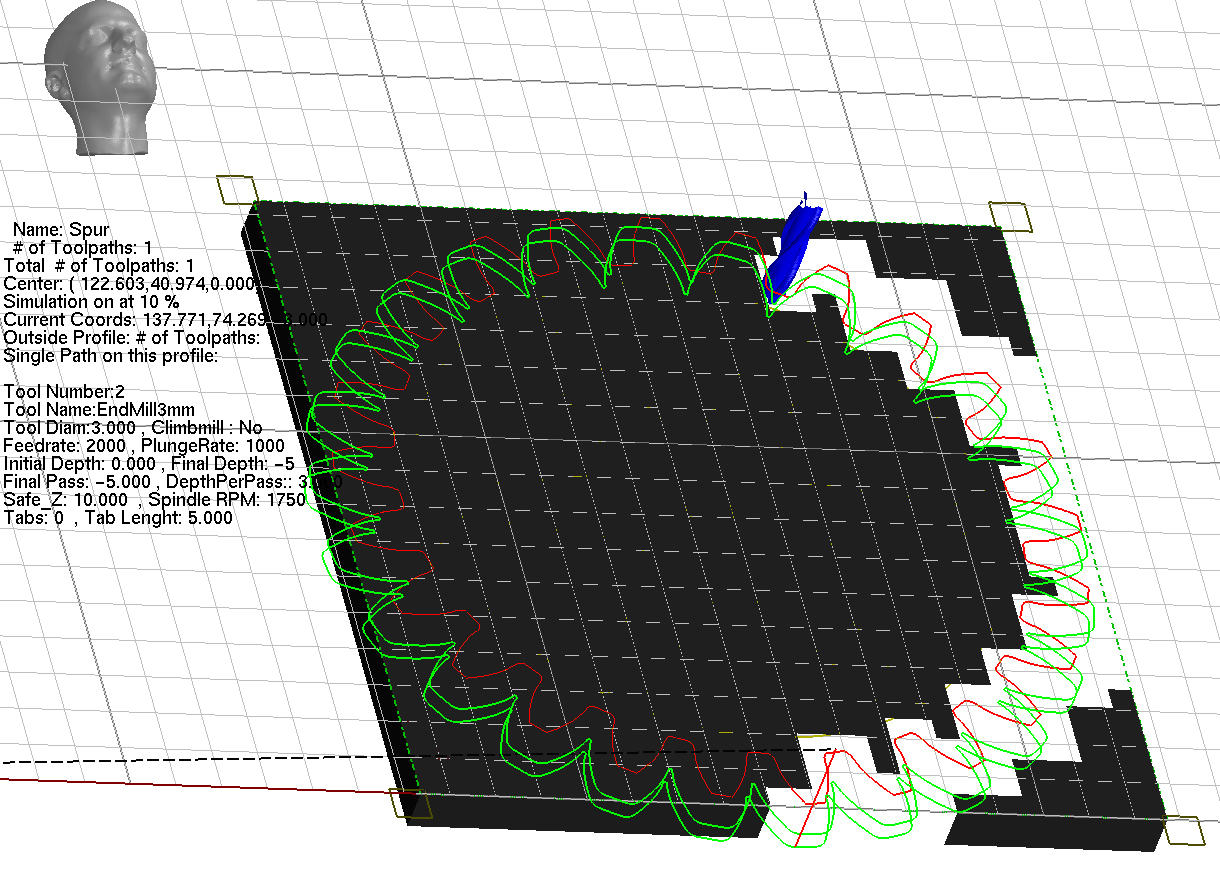

For some reason when I toolpath a non circular gear and run simulation or in Mach4 the tool pauses, raises up and then down in Z as it is makes every pass...
I down loaded the older version and it "cuts" properly...dropping the Z the proper pass depth as it goes around inside the gear ??

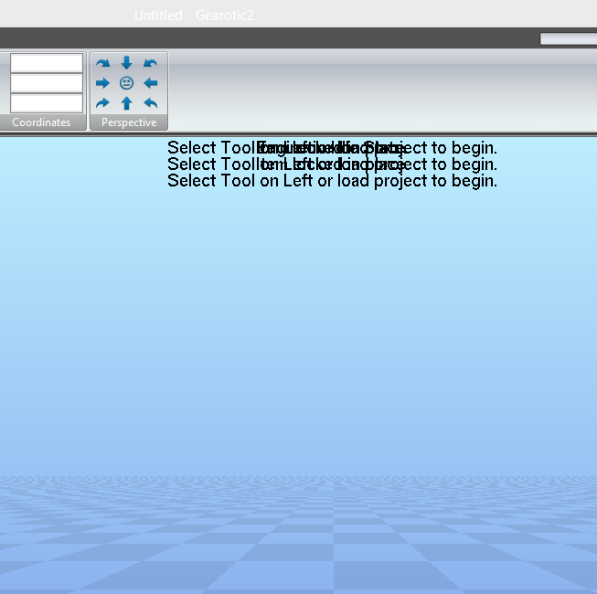

Also missing the text next to: Depth, Final Pass and safe Z ..
