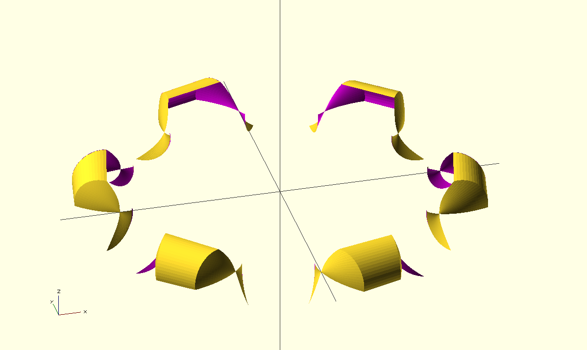

When I started generating bevel gears, I set them up so that the (idealized) contact line between the teeth would always go through the tip of the pitch cone. That makes the gears symmetric and allows for a system of many different bevel angles that all mesh with each other, but it's not the only option.ArtF wrote:...
The problem with them is that they really lend themselves only to engraving type of cutting on 3d , not 4th axis as you
cant shave the tangents in 4th axis.
Now, let's suppose, instead, that we design a set of bevel gears so that the idealized contact line between the teeth is parallel to the shaft of one of the gears. Then we would end up with an asymmetric bevel gear pair - one of the gears could be an involute spur gear, and we'll call the other one a crown gear.
I need to do some pencil and paper work to be sure that the it works out, but this sort of crown gear should have the nice properties that:
For a 90 degree drive, it should be possible to 'tangentially shave' the tooth flanks using a taper nose end mill and a 3 axis CNC machine (or, for the masochist, even on a conventional 3 axis machine with a rotary table).
It should mesh well with a range of involute spur gears that have the same pressure angle and pitch.
It should be mechanically viable with decent efficiency, little noise, reasonable meshing tolerances and so on.
(This seems like such a good idea that it's probably either wrong, or someone else thought of it well before I did.)

Yes, when I use the term "engraving" I really mean 3 d raster cutting on a plane. It leaves really nasty toolmarks unlessdon ein a tight raster, which is why I resist it so much as a bevel technique. As you your idea of using a
tangent to shaft as the idealized contact point, I cant quite picture how a normal spur can run on a 90 degree bevel, dont the teeth have to narrow toward center?

Yes, the teeth have to narrow, but they don't have to narrow along a radius. I need to think about it a bit more, and I'll see about modelling it....
As you your idea of using a tangent to shaft as the idealized contact point, I cant quite picture how a normal spur can run on a 90 degree bevel, don't the teeth have to narrow toward center?
