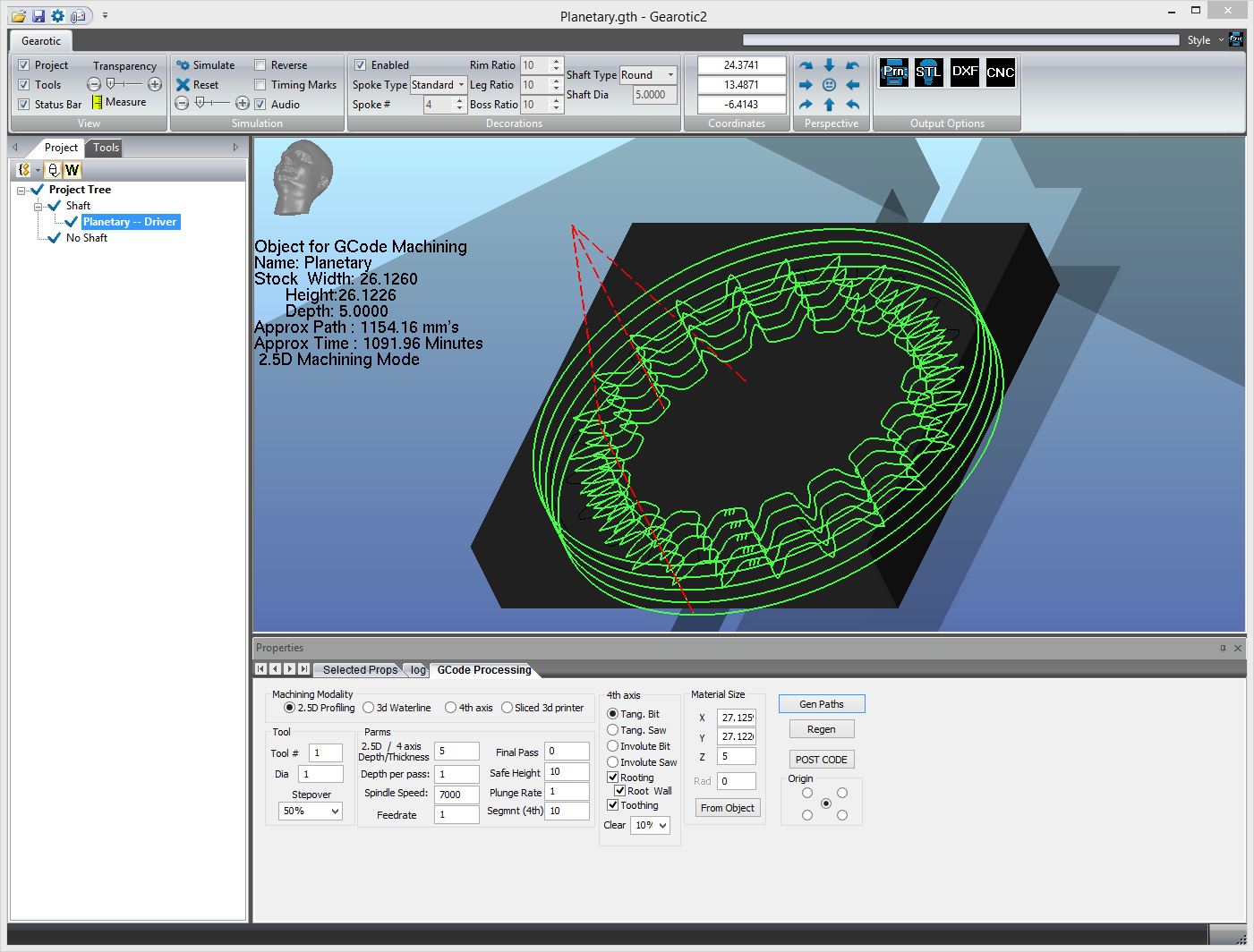

Re: Planetary Gear GCode
Attached is the project file after creating the toolpath. On reloading I can't see the toolpath.
The steps I take are:
start gearotic 2
open Planetary.gth
click Output Options/CNC
click Project Tree/Shaft/Planetary--Driver
click Gen Paths
Artifacts should now be visible. there are three on one tooth and repeated for each pass
(5 here because I haven't changed the thickness to 2.8)
I've also attached a jpg of the window showing the artifacts.
Hope this is enough to reproduce.
Pat
start gearotic 2
open Planetary.gth
click Gen Paths
Pat
Hi Pat:
Ahhhhh, a light bulb goes off. Sorry for the confusion.
Can you upgrade to the DEV version of the software. Its CNC functions will not have that problem.
I will look to updating the release version to get rid of that bug. The DEV version has a much improved
CNC section with a built in simulator for checking such things. (Its why you didnt understand my
comments on the sim. or the workbench being saved.)
Update to DEV version, then , after opening the program, click the large question mark on top menu, then
watch the video on the CNC Workbench for how to use it. Its toolpaths will not have that bug in them.
(this is why I couldnt reproduce it.) Yell if you run into difficulty, Ill help you as you go..
