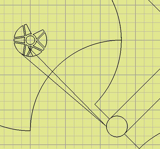

5. Geneva ratchet crosses have spokes whether decorations are enabled or not on the tool screen. When added to a project, the spokes will only be present if they were enabled, as it should be. But when sent to the workbench, spokes will be there even if they were not part of the cross on the project screen.

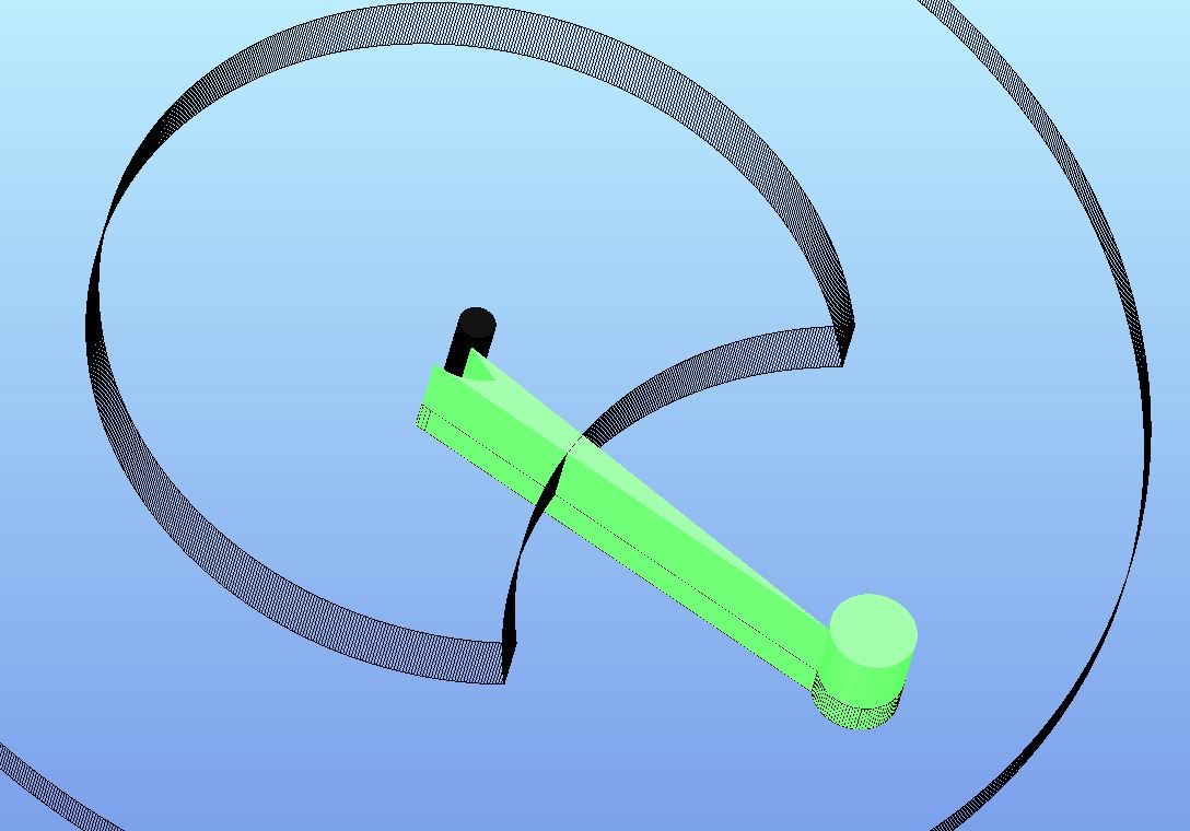

6. The DriverPin on a Geneva ratchet will become a tangled geometry on the tool, project and workbench screens if the GenevaDriver wheel is big enough to have spokes. Again, whether spokes are enabled or not. Also, spokes of any type on the GenevaDriver wheel do not generate correctly on the tool screen, having various missing line/arc segments. And GenevaDriver wheel spokes do not continue on to the project and workbench screens. See the two attached DriverPin jpegs.

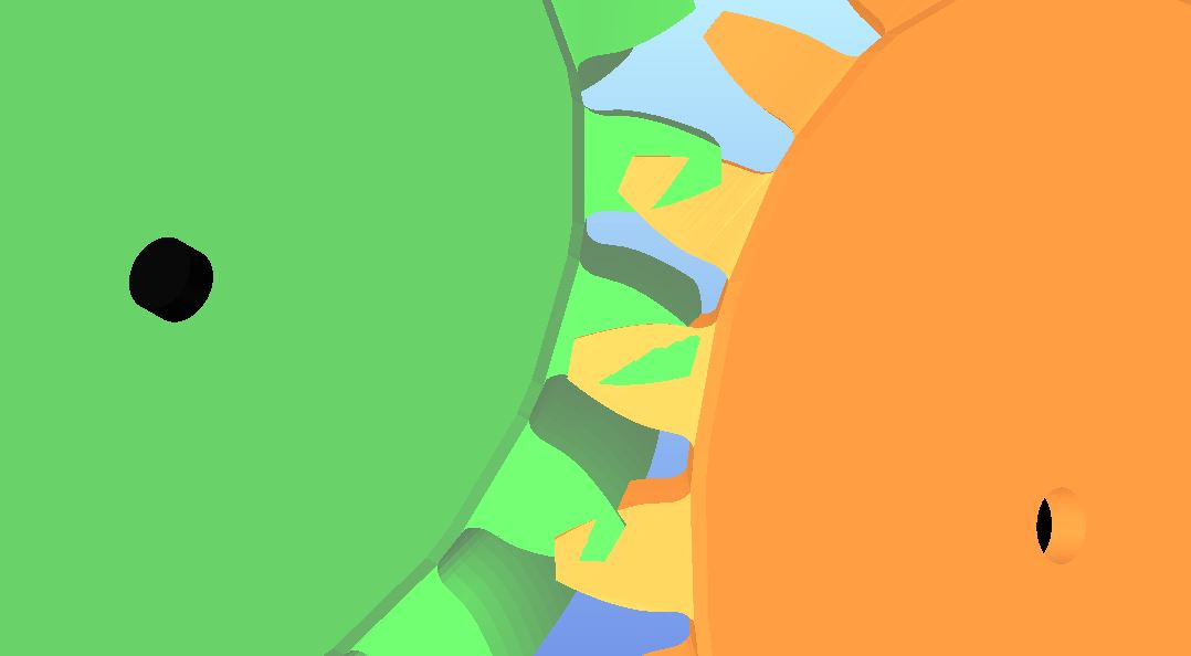

8. In the Circular Gear Module, select Bevel. Anything can be set in the Bevel Params area. If the pinion tooth count is not equal to and greater than the wheel tooth count, the two bevels no longer mesh and their faces are parallel and offset.
9. With the two paralleled bevels on the tool screen, click Add Wheel to Proj and then click Add Pinion to Proj. The two bevels are parallel in the project screen just like they are on the tool screen. However if the pinion is added first, then they are placed correctly and they mesh.
10. Regardless of which bevel is placed first in a project, when the bevel pinion tooth count exceeds the bevel wheel tooth count, the bevel wheel geometry on the project screen is cheesed. Face width is way thinner and the tooth tips are parallel with the face. Yoiks!

5. Geneva ratchet crosses have spokes whether decoratio ns are enabled or not on the tool screen. When added to a project, the spokes will only be present if they were enabled, as it should be. But when sent to the workbench, spokes will be there even if they were not part of the cross on the project screen.
>> Definite bug. Im of the opinion Geneva's shouldnt have spokes..
6. The DriverPin on a Geneva ratchet will become a tangled geometry on the tool, project and workbench screens if the GenevaDri ver wheel is big enough to have spokes. Again, whether spokes are enabled or not. Also, spokes of any type on the GenevaDri ver wheel do not generate correctly on the tool screen, having various missing line/arc segments. And GenevaDri ver wheel spokes do not continue on to the project and workbench screens. See the two attached DriverPin jpegs.
>>Same bug I think..different symptom
>> Ill check that. Looks like a kennel of adoptees this version..
9. With the two parallele d bevels on the tool screen, click Add Wheel to Proj and then click Add Pinion to Proj. The two bevels are parallel in the project screen just like they are on the tool screen. However if the pinion is added first, then they are placed correctly and they mesh.
>> Noted.
10. Regardles s of which bevel is placed first in a project, when the bevel pinion tooth count exceeds the bevel wheel tooth count, the bevel wheel geometry on the project screen is cheesed. Face width is way thinner and the tooth tips are parallel with the face. Yoiks!
>>Its obvious I havent placed many bevel recently..
11. Bevels, good or bad, can only be sent to the workbench for some reason but cannot be sent to 4th axis. At least for me. Am I doing something wrong? Or maybe this code isnt available yet?
>> Not available yet. You cant machine a bevel in any mode as of yet, they are pretty special in terms of tryign to machine them, typically, it takes 5 axis to do a bevel..

4) Geneva ratchet crosses have spokes whether decoratio ns are enabled or not on the tool screen. When added to a project, the spokes will only be present if they were enabled, as it should be. But when sent to the workbench, spokes will be there even if they were not part of the cross on the project screen.
Couldnt really replaicte to your example, however, the spoke setting was clearly bugged. It is now fixed. The wheel doesnt have spokes at all, only the pinion
was meant to allow them.

6-8)
This relates to changing formulas to industry standards. The calcs use alot of pinion vs wheel comparisons. In this formulation, unlike older gearotics,
a pinion is much more related to the wheel. While Gearotic is usually lax in the definition of wheel and pinion, it seems in the case of bevels we must
be much more picky. So in future, bevel Pinions must have no more teeth than the wheel. A wheel is then in bevels at least, considered to be the gear
with the greatest number of teeth. Ive limited the pinion to be less or equal to the wheel. This fixes the trouble. One must in future make the wheel the
largesat gear. Im reticent to make great changes in this section, its incredibly complex at this point with all the various standards used, but I think
this simple change allows everythign to work with the least chance of inducing greater troubles.
