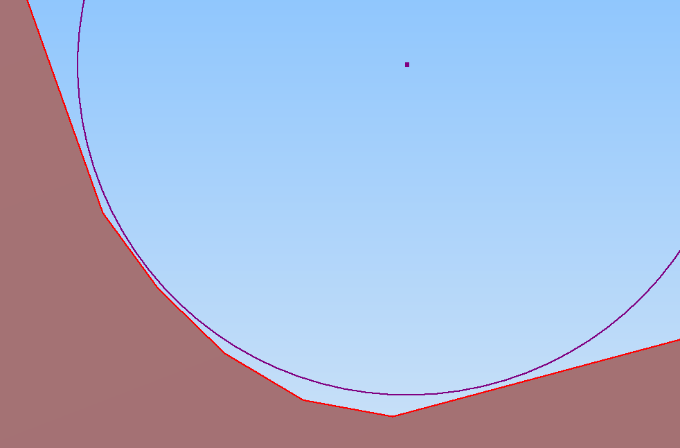

Thanks for the reply! When I import the dxf into Acad Inventor I can't dimension any of it as it all just little tiny line segments(hundreds of them). I import dxf's into IV all the time and its not usually like this.
Ideally I would just pull enough dimensions in IV for one tooth, then input that info into my proto trak and rotate it.
Second choice would be to use Onecnc and run it on my little machine with Mach3. The size of some of the gears is pushing it for my little one.
Paul
I attached a close up snip of what I am seeing.
Paul

Im still not understanding the issue, but then I dont use inventor at all. Any DXF which approximates
a formulaic arc (involutes in this case) has to either use line segments or arc segments for that curve, Gearotic used line segments as they are more universal than arc segements for most users and pretty much all DXF importers
will accept line segment. What are you expecting ( or hoping :) ) to see? Beziers or Arc segementation?
Im unsure why one would try to approximate a tooth or copy one to create a toolpath? why not just
ask Gearotic to put out the Gcode for the gear itself.. or just select the line segements that make up a tooth
and rotate it? If you can explain the issue I may be able to show a work around..

Yes, the number of segments is far above that necessary to make the gear face quite smooth. I can make it smoother with more points , but over
time the right number of points seems to be about what is set, weve had complaints of too many and too few.. which adjusted the total, but there havent been any complaints of segmentation number for over 2 years now so I think we're just about right. .
In 4th axis we typically cut about 8 segements per tooth with no problem,
in 2.5D the segments youll get is up around 50 or so, way above the point at which youd notice. In the end, "smooth" is defined by not the absence
of line segments, but the greatest number of them. ( A perfect arc is infinite line segments really..).
The problem in such things is always where you draw the line. If I increase the segmentation to huge numbers, the program would slow
considerably with no real improvement in the gear you make.. but then, all things are relative and some people may need much higher
levels of smoothness for whatever reason, shoudl that happen let me know and I can probably make it so for you.
Take note too that noncircular gears are special in that they are built using digital subtraction techniuques so can be rough edges in the root moreso than anywhere else, this too can be made smoother by special request if one need it, so far noone has requested such a fix.. but you never know.. could happen. :)
