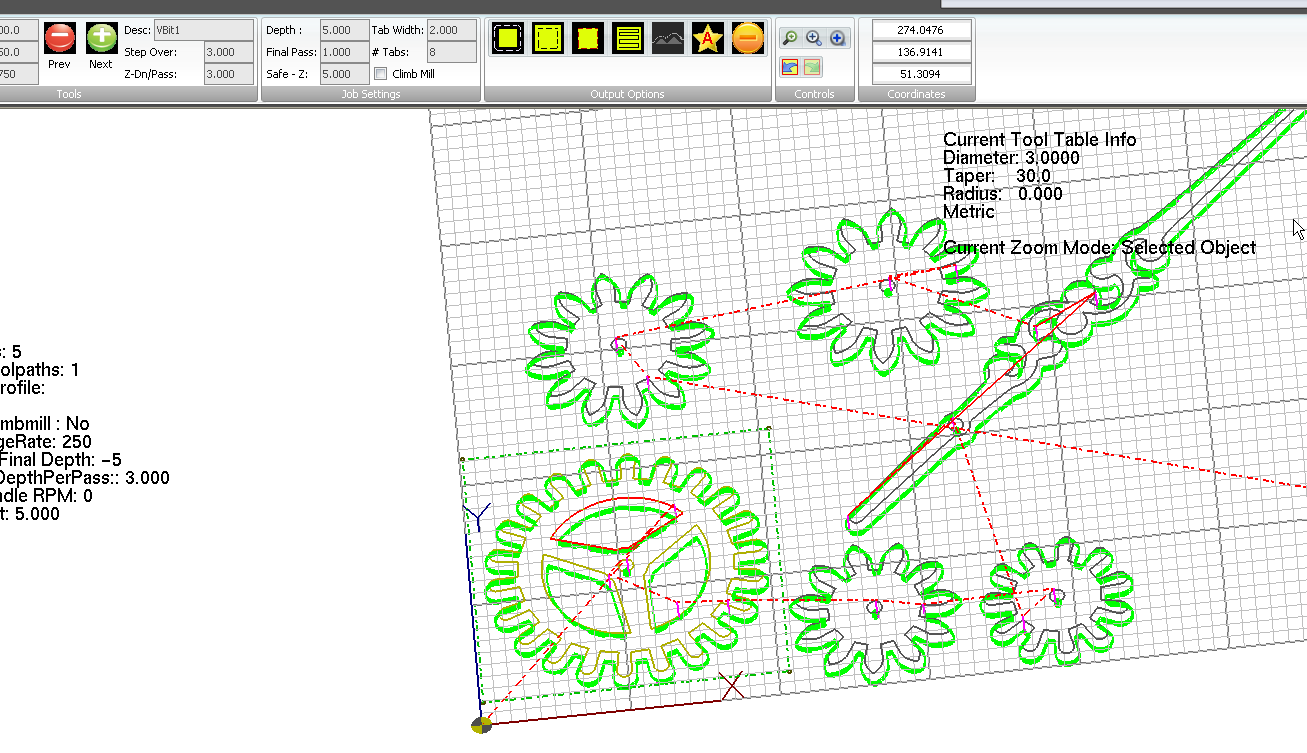

On that note I'm well along the new CNC module and hope to release the preliminary version within a few weeks. Its a large module with lots of new code so its taking
me quite awhile, but I think most will like the new format much more than the old. It also paves the way for a CAD module to make things much more interesting.
The new module will allow multiple items to be machined as one job, rotated and placed as you wish, nesting more than one copy of an item, automatic toolpaths as well as selecting inside, outside or center-line profiles as well as pocketing and engraving and will include a post processor just in case your using a non-mach3 system.

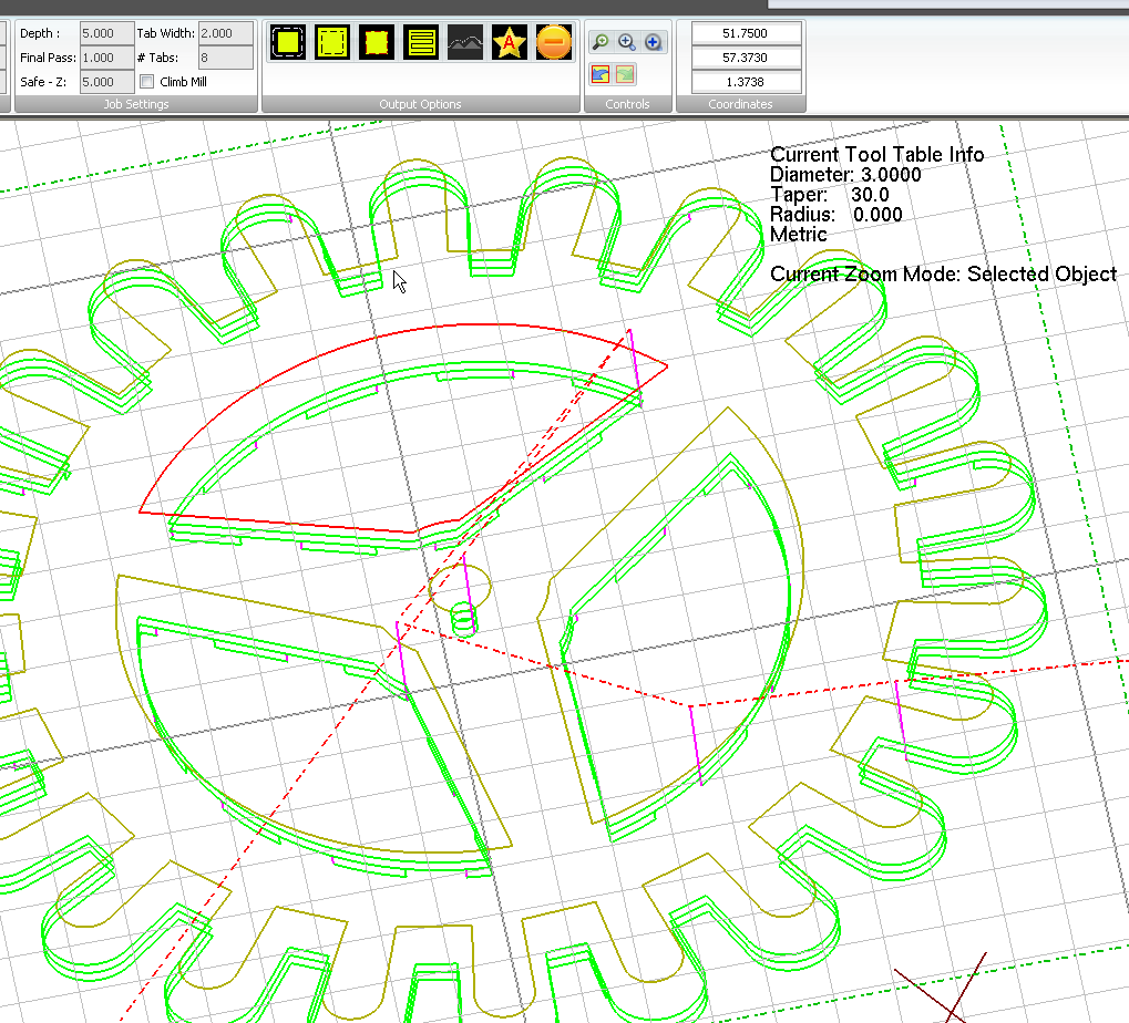

Any chance the new CNC module will contain tabs?
Re: New Release 2.10
Good Idea, that was on my list and I haven't dealt with it., Luckily, this is the right time to mention that so Ill
add that to the mix. Might mean a bit more debugging due to complexity, but I think its something worth doing.
I'm thinking of having the tabs only operative on a final pass depth..
As its working now, you specify a final depth..that forces the system to ensure the last pass is a set depth,
my though is tabs would be easier to breakout if only done on the final pass if one is specified.. any thoughts?
So to be clear the profile would be cut to depth-lastpass depth, with no tabs, then the last pass would cut with tabs
every "user specified" distance along that pass lifting to the height of the previous pass for the tab width then plunging back
down to final depth , leaving easily cut tabs. A user could then know that the final pass depth is the thickness of the tabs
called for...
I dont normally use tabs, does that sound OK, or do you think you'd prefer full depth tabs.. Im just trying to keep
complexity to a minimum..the more settings you have the more complex users tend to find things..
I use tabs in Aspire and having them on the last pass is perfect. Since I use small bits - 1/16" is my favourite - I have broken more that one bit when a gear shifts slightly on the last pass and "jams". I can't wait that that one!!
Last pass it is. ( I hate thick tabs..)..Already started adding the code.
Last pass sounds fine for me, too. I don't know if it's worth specifying a less than full depth for them - my thought is varying the depth per pass slightly so the last pass is whatever tab thickness works out.
Do you need to think about a tab count and width, or can they be a constant number and angle (or minimum width)? A bit of googling suggests some potential options, minimum tab count, distance between tabs (affected by minimum), and tab width. For example, say one tab every 20mm, 3 minimum, 3mm wide. If you have, say, a 61mm perimeter (based on radius, not travel around the teeth ) then you get 4 (always round up?). If it's 40 you get 3, if the perimeter is less than 12mm then it's just solid and you need to dig out the xacto knife.
For first go around, Im setting it so you specify the number of tabs per profile and their width.
If a profile is too small, no tabs will be made.. or it may be solid.. ( I havent decided..), but generally if you sepeciy 4 tabs of 2mm width, youll generally get one at each 90 degree point... etc

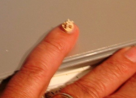

This looks great - I've had some close encounters between fingers and cutter on really small gears. No more such adrenaline rushes!
Looks good! Thanks! It looks like you've put them in the spoke cutouts too.
I'd vote for solid rather than none on small parts. It might be more trouble to trim them off, but the little guys are more easily damaged if they move around.
John - being a bit accident prone, and since it's more fun to watch somebody else being sutured (they sometimes let medics watch here if you're quiet and say how much you appreciate it later) I use old toothbrush handles to hold parts for the last few seconds of cutting.
