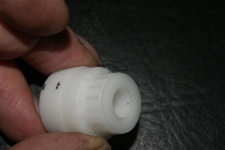

Here are two photos that show that most of the teeth are being cut off.

Looks like the A rotation is backwards from GM's expectation. Can you reverse the direction bit so the A axis is reversed and give it another shot. When the Axis moves to the Y++ direction, the rotations should also be to the same direction.. I cant tell from the video which flank your on
so I cant tell if GM is wrong or you are, but Im pretty sure thats going backwards to the executing code.

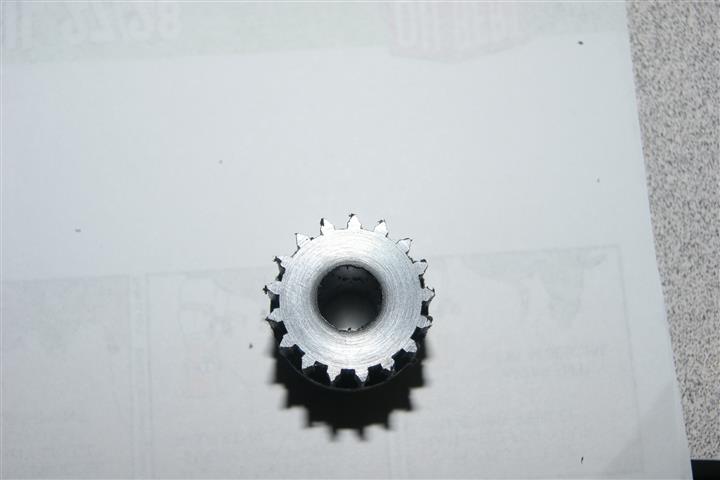

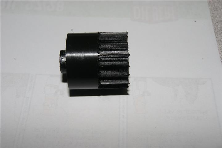

Thank you O Supreme Grand Master of all gearheads! That did it . I reversed the A axis direction and just cut a nice looking gear. I need to make another one as the face width wasn't quite right but since it was a test that's ok. I can fix that. I have attached a couple photos that hopefully show the involute teeth. There are some burrs on the end of some teeth. Otherwise the gear fits the circular rack perfectly. This saves me about $1070 because that's what Mercedes Benz wanted for a replacement windshield wiper transmission. They say they don't make replacement gears so you have to buy a new transmission. There are no after market replacement gears. It's interesting how it works. On My S320 the windshield wiper not only moves back and forth like most but unlike most it extends and retracts during a portion of the travel so that the driver side windshield is completely wiped without hitting anything..

Hi Dan:
The teeth on that gear look thinned ( but I cant see them clearly enough).. perhaps the bit is a touch too large in diameter..or the blank was a touch too small. ( The blank diameter is pretty sensitive and the tool diameter isnt great at reporting if its too large..

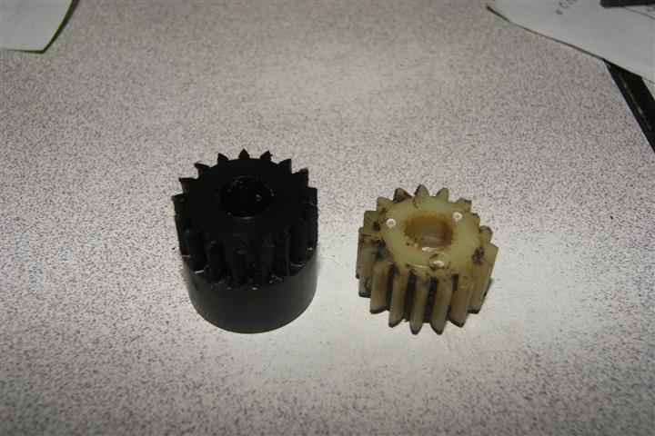

I'm using a .0375D EM. The blank is .944D and there are 17 teeth. I looked under a magnifying lens at the old gear and the new gear does look thin. The information I have is that is the correct diameter and the CNC portion of the program doesn't have an issue with the .0375D EM The root measures at .070 which is more than the cutters width. It seems like the program is making the root wider than the bit and thus is thinning the teeth. While it's difficult to measure the old gear teeth at their widest point is ~.092 and the new gear measures ~.072. So you think I should increase the diameter? How much should I increase the diameter? You best guess is fine.

Id try setting the bit size as .04 ( 7% increase for a 7% loss in width) and see what it does.

In the cnc module I increased the EM size to .04 however the teeth are still thin and not quite right. Here are some pictures. I measured the root and it was still oversize in that the width of the new gear root was .078. The original gear root width is .06.
Any help is appreciated. BYW I can upload another video of this latest gear being machined.

My apologies I just went out to double check the diameter of the end mill with my tenth mike and found that the cutter is .061D not.0375 . I most have forgot to zero my caliper when I first checked it.. I'll redo the G code and see if that works better.
