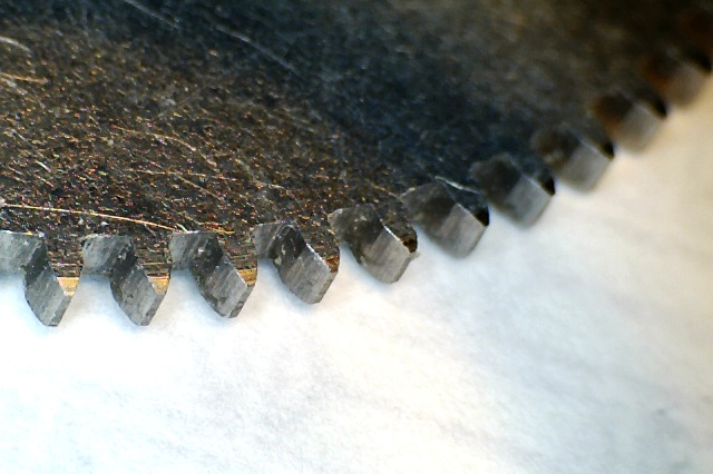

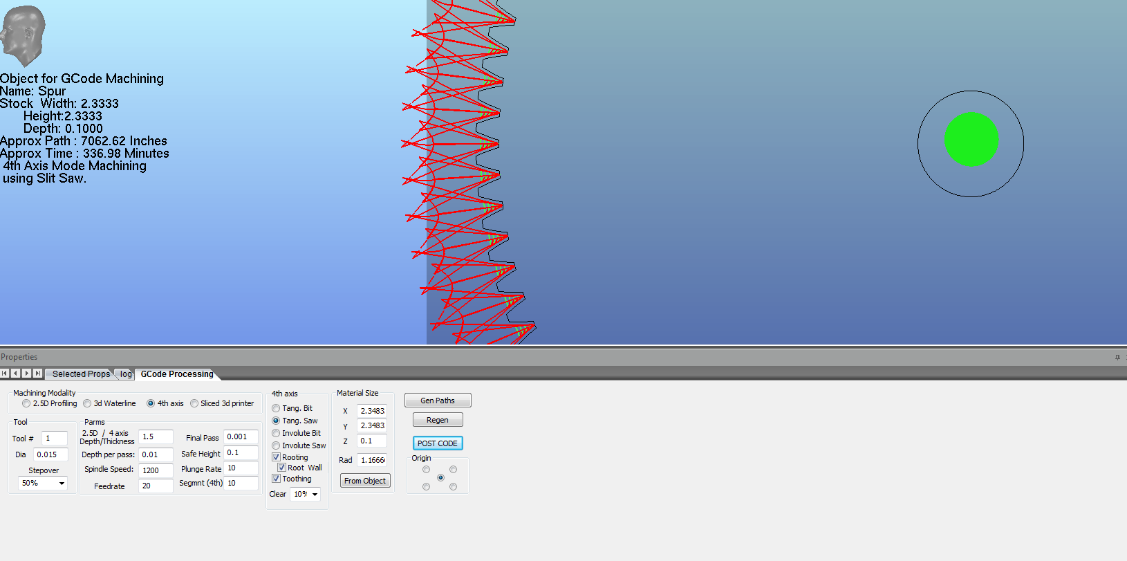

I am experimenting with the use of very fine slitting saws to cut brass clock gears. I have had success using the saw in 4th axis G code when calling it an involute cutter, but obviously this only produces a straight tooth.
When I select tangential saw Gearotic 2 (latest current development) the shaving pathways appear to generate OK but all in not well in Mach3. Using exactly the same set up that cut a straight tooth the cutter advances and appears to cut a tooth, but 4 axis rotation continues and the Y axis cuts much too deep and the routine has to be terminated. This takes place at Z +0.200inch not Z 0.0 which suggests to me part of the shaving routine. I have attached the file, could someone check to see what I have done wrong?

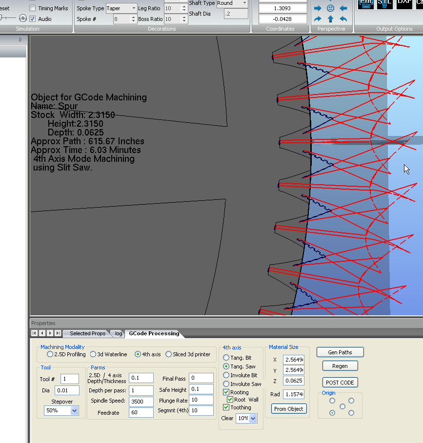

Cant you take a snapshot of what you get and compare it to this shot? Yours will show the actual thickness of the blade entered
in the tool diameter and the depth etc.. In the end you should be able to zoom in as I did here to see how the blade should cut..

Have set up a gear to the same parameters, and attached a screen shot (using gearotic screen shot gave only a white rectangle) so this shot done another way.
All seems the same except the material size boxes which are different and no wavy black lines for the shaving.

Something isnt matching up well with this gear, to be honest Its much smaller than I anticipated in design, so Im seeing if I can track down the error,
doesnt seem too deep to me though, seems to be shaving outside the disk..

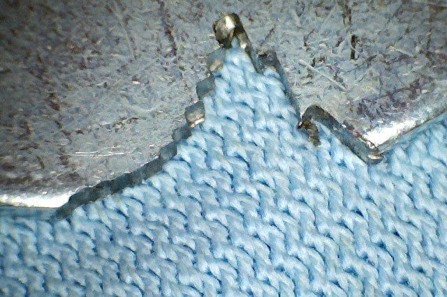

I tried cutting an 8 tooth 4 mod gear just as a trial, given that you think the small size might be a problem.
I used a 2" blank, a 2.75 diameter saw 37 thou thick, X and Z axis zeroed on rotary table centreline, Y zeroed just touching blank at X=0, Z=0. Table facing X--.
The first side of first tooth seems OK, though some air cut, as soon as the A axis turns cut is applied via Y the saw plunges and bends under the A motion.

Attached gth file, screen shot, tap file and a picture of cut.

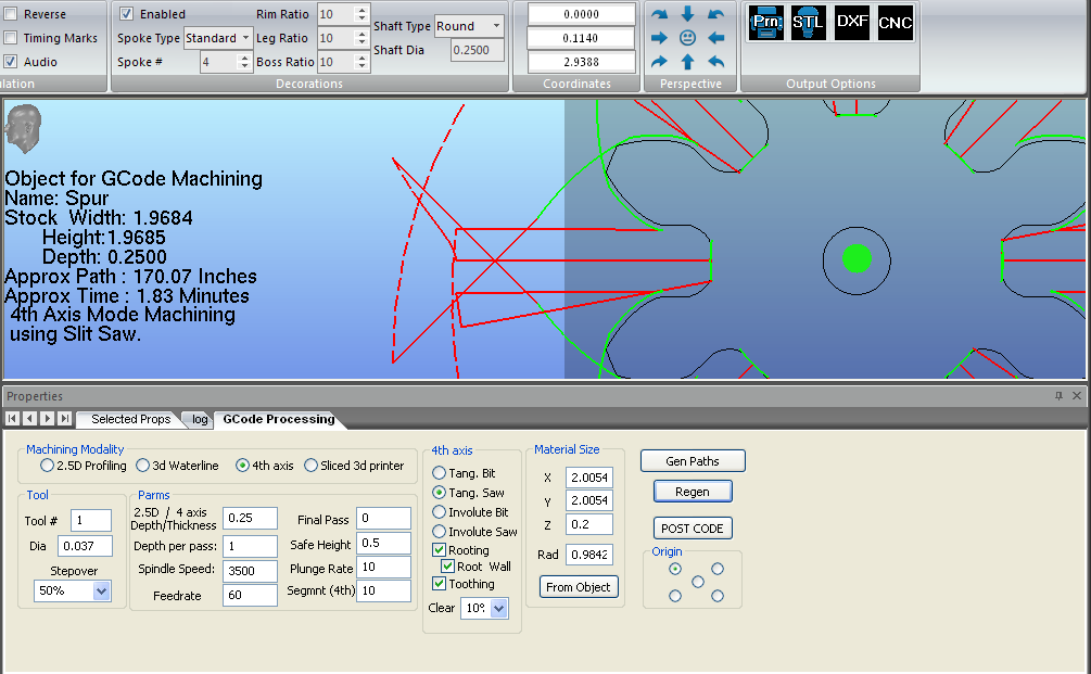

Loaded new version and tried the same 2" diameter 8 tooth approx 5 module gear as before.
X and Z zeroed to rotary table axis Y to edge blank. A full 2" width giving a large saw clearance well past full cut depth.
First side first tooth seemed OK, noticed that direction cut reversed with each change in Z axis, so some normal and some climb cuts.
Another odd thing as Z down increased the saw cut the blank at Y zero! Z was accurately zeroed to plus or minus a thou.
Disaster struck around line 500 plus on the code, after a small A rotation (Cleared cutter) there was a larger rotation (cleared cutter) then then a 0.25" or more Y movement then an X cut breaking the saw and bending the blank.
Attached gth and tap.
Could this be a shaving cut with the A axis rotating in wrong direction rather than moving to next tooth?
