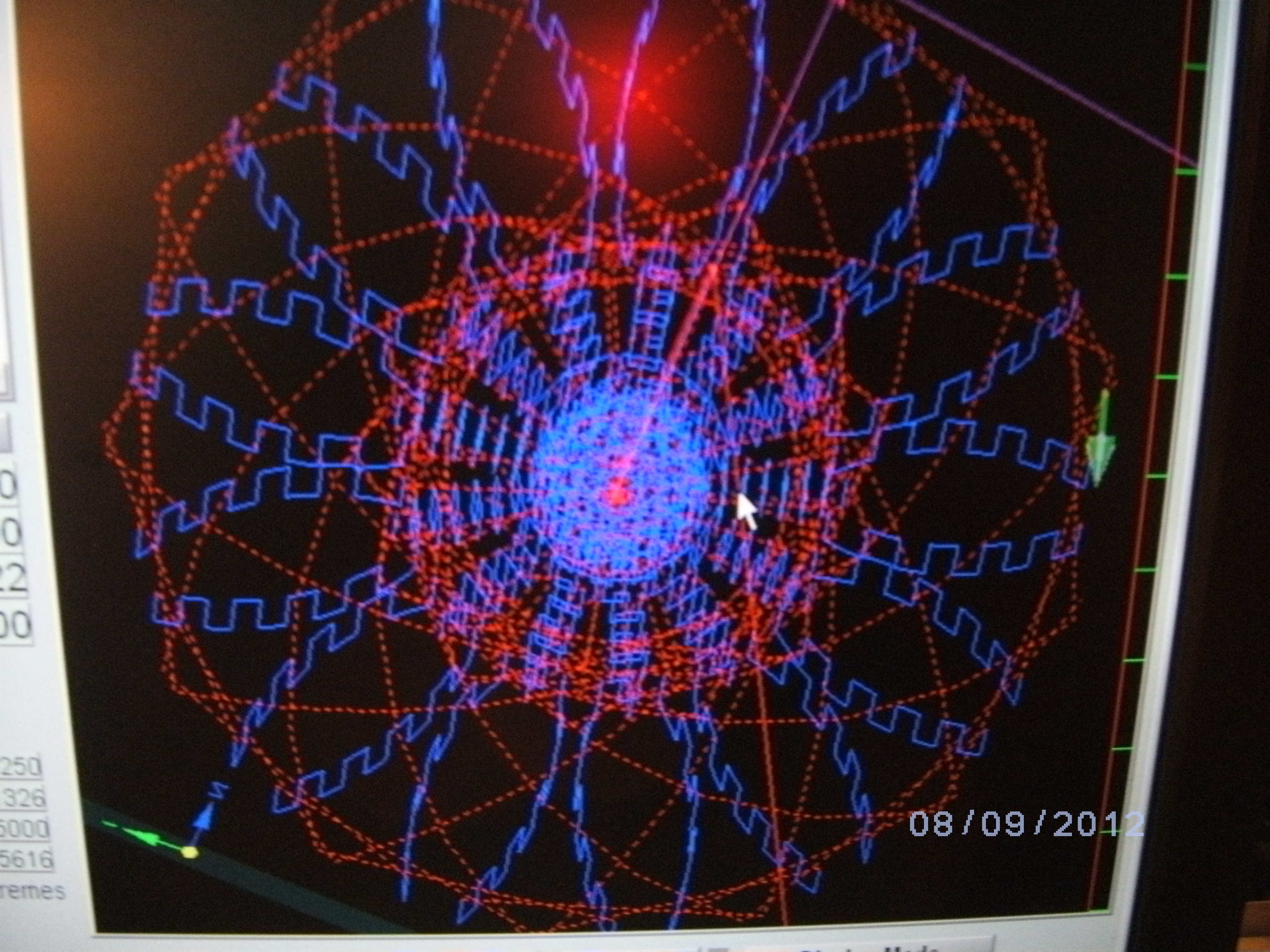

Re: cutting in 4th axis
Can you post a photo of the toolpath displayed? I know the 4th axis is a bit confusing in GT, and its being
rewritten for the fall. I intend to write a simulator for it so we can verify on any job what the end result should
look like.
Hi Art here is the tap file.
Joe
Yes, lol.. something definitely wrong there. Im thinking depth per pass or some setting is negative when it should be positive or something.
Can you pose the project file.. the gth file so I can test that file. Let me know the tool size and such..

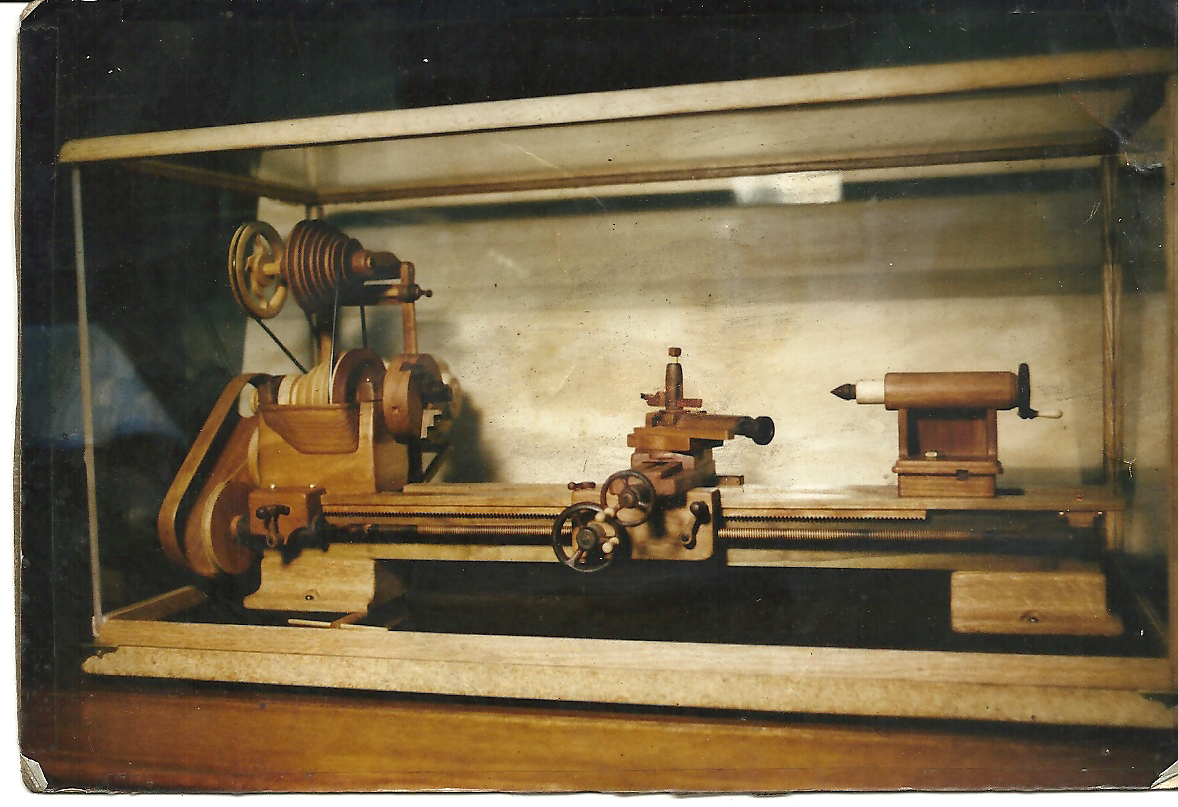

Awesome. :)
Love the lathe.
Ill analyse and get back to you.
Love the lathe.

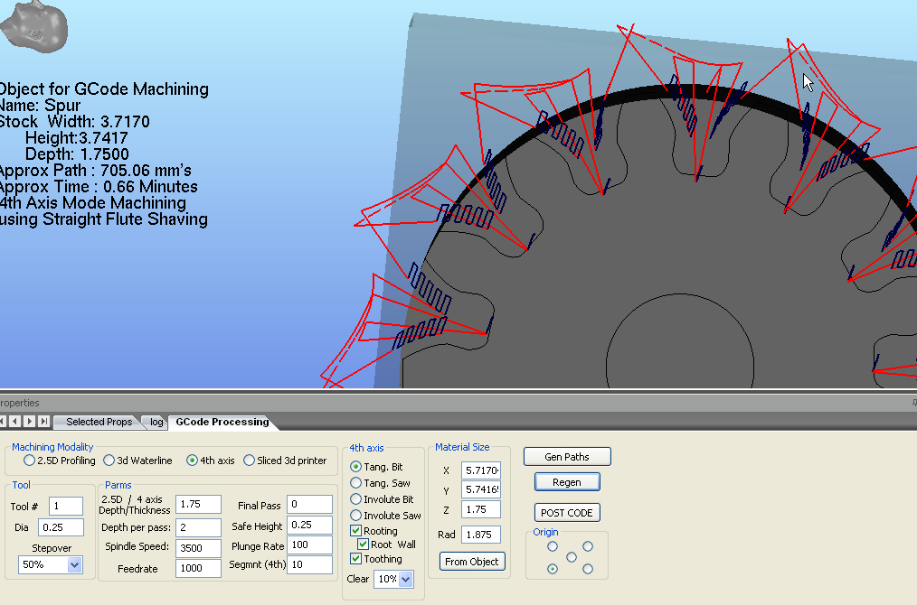

Joe:
Not sure what setting you have out of tolerance, but heres a snapshot of my screen on the same gear. I include the numbers
section so you can compare to what you have set. Your toolpath should look more liek this one.. Let me know what was off
if you can, Ill make sure I limit it in the new module this fall...
