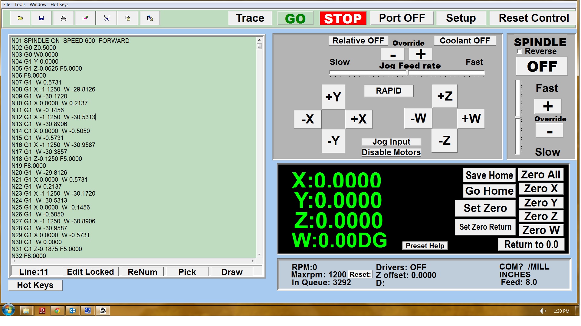

this machine is a 3 axis cnc with a 4th axis rotary table which in their software the letter is w. the code will work once the a is changed to w. i have to take out some of the notes at the top, open it up in my software and renumber your code with my software, save it then i can use it. both party software here are almost on the same page. i will attatch a sample text file from my other cad programs that work directly with the cnc software. once this file is output from the cad this is how it should look. thanks for all your help and everyone else's help as well!! we all like to learn new tricks of the trade.
