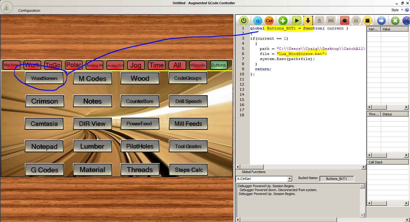

http://youtu.be/ZRhQN331na8
Video shows a created button panel calling Notepad and Lua scripts, and some additional control capabilities.
Here is an idea of an example function that gets data and computes a circular drilling hole pattern
