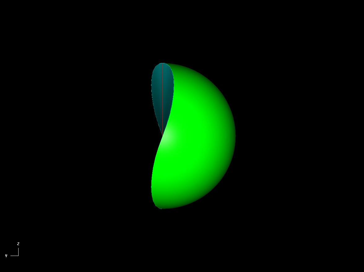

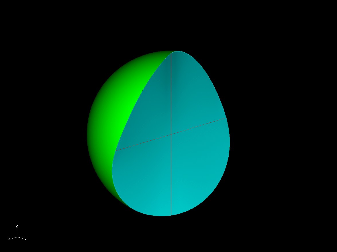

Hi Art, I tried to draw what I meant. Sort of looks like a potato chip. The line passes through 2 sets of axes at the same angle. From the side it looks like a figure 8. Imagine the rack going around the circumference and 2 opposite tooth flanks are on the surface.
Cheers Damo
Not sure if this will work, am attaching 2 images
Re: Machining Bevels.
I see what you mean, it is a figure 8 on profile..  Im just not sure how that helps me in terms of getting the rigth profile..
Its interesting to note that the specification for the calculation of the bevel toothform produces a very bad looking curve in the
axial plane..its only once you fold that to spherical that the curve looks correct as a semi-evolute..
