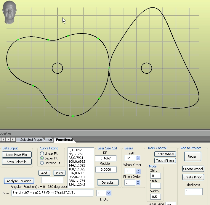

Re: Version 2.281
  Thought you might like to see a snapshot of the next module. It will be a long video
I suspect. This is probably the most requested feature over the years, be interesting
to see what people make of it.
