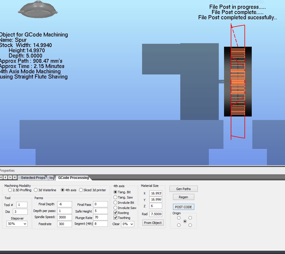

Trying to run the straight spur but there seems to be something wrong with the gcode values versus the gear blank thickness. See attached. The gear blank is 5mm thick but the x axis only cycles between X+1.5 and X-1.5, which is the tool diameter. clearance is zero!!!
Phil :)
Phil :)
Re: 45 degree worm M2.5
Damn..what the hell did I break while in there... Ill fix that very shortly.

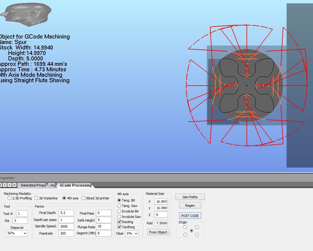

Phil:
Set your final depth as a positive number.. In 4th it translates to "final Thickness" and a negative number had an unknown effect.. (Ill fix that..).
Had me wondering why it worked here.. till I saw the final depth.. Now Im wondering if that affected other cuts, it basically caused a mirror of the path on my system...

Then I'm confused. What has final depth got to do with the blank thickness, final depth should be fixed at the distance the root is below the top of the blank (the z = 0 point). Why does the CNC processing redefine the blank thickness This is confusion total confusion!!!!!!
Phil :)
Phil :)

Phil:
Not so confusing when you consider its history. We started with 2.5D only. Now consider that a person designs a gear with a facewidth of 5mm.
So they go to cut it in 2.5D. Its unlikley they will use 5mm as their depth of cut, the actual thickness considered is taken from the object, but is overridable by "Max Depth.". This allows a person with that 5mm thick gear to cut it from 12mm material or whwtever they wish. So far so good, now he can cut 5mm or 12 mm or whatever, by using the "Max Depth." field.
Now consider the 4th axis. "Max Depth" has the exact same function, it allows for a thicker cut. Its unfortunate that the term to a gear designer
refers to the depth from tip to root, but then that's not a setting that would be usefull at all, who wants to cut a tooth to a variable depth, a tooth
is always cut to its design depth or it simply isnt usefull. But having the "Max Depth" work in 2.5D and in 4th axis having the same effect made sense.
As Ive said this was all done and explained at the time as a holder, a better system than GM's, that would be redone in grander scale
when all else in GT caught up. Its simply a handy way of making the gear thicker without having to go back and redesign it. I did fail
however to catch negative numbers.....
Most of the settings will become more intuitive when its recoded, but "Max Depth" is simply a thickness modifier. You cannot, nor I suspect would you want to control the depth of a tooth in the toolpath generator.

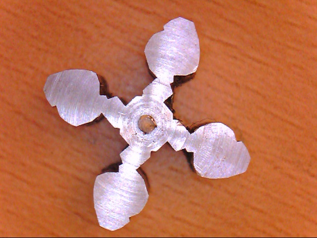

Art, here's the M2.5, 4 tooth spur
Phil :)
Phil :)
