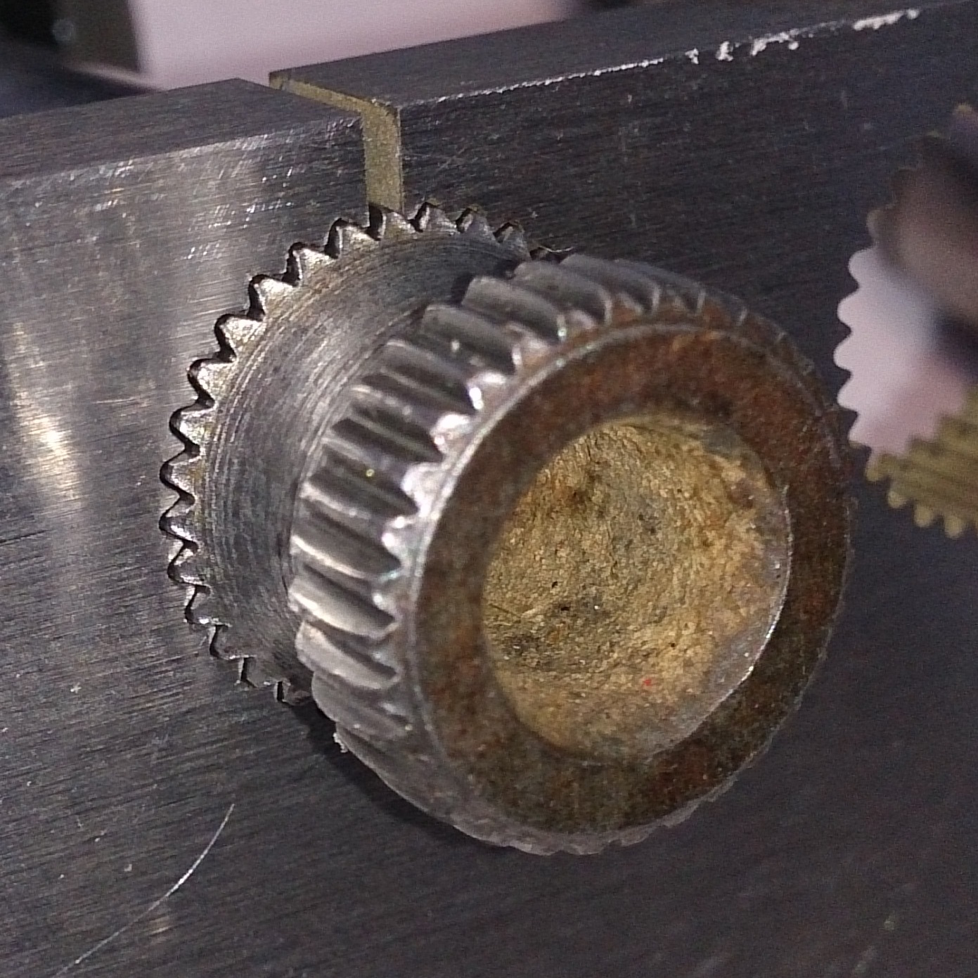

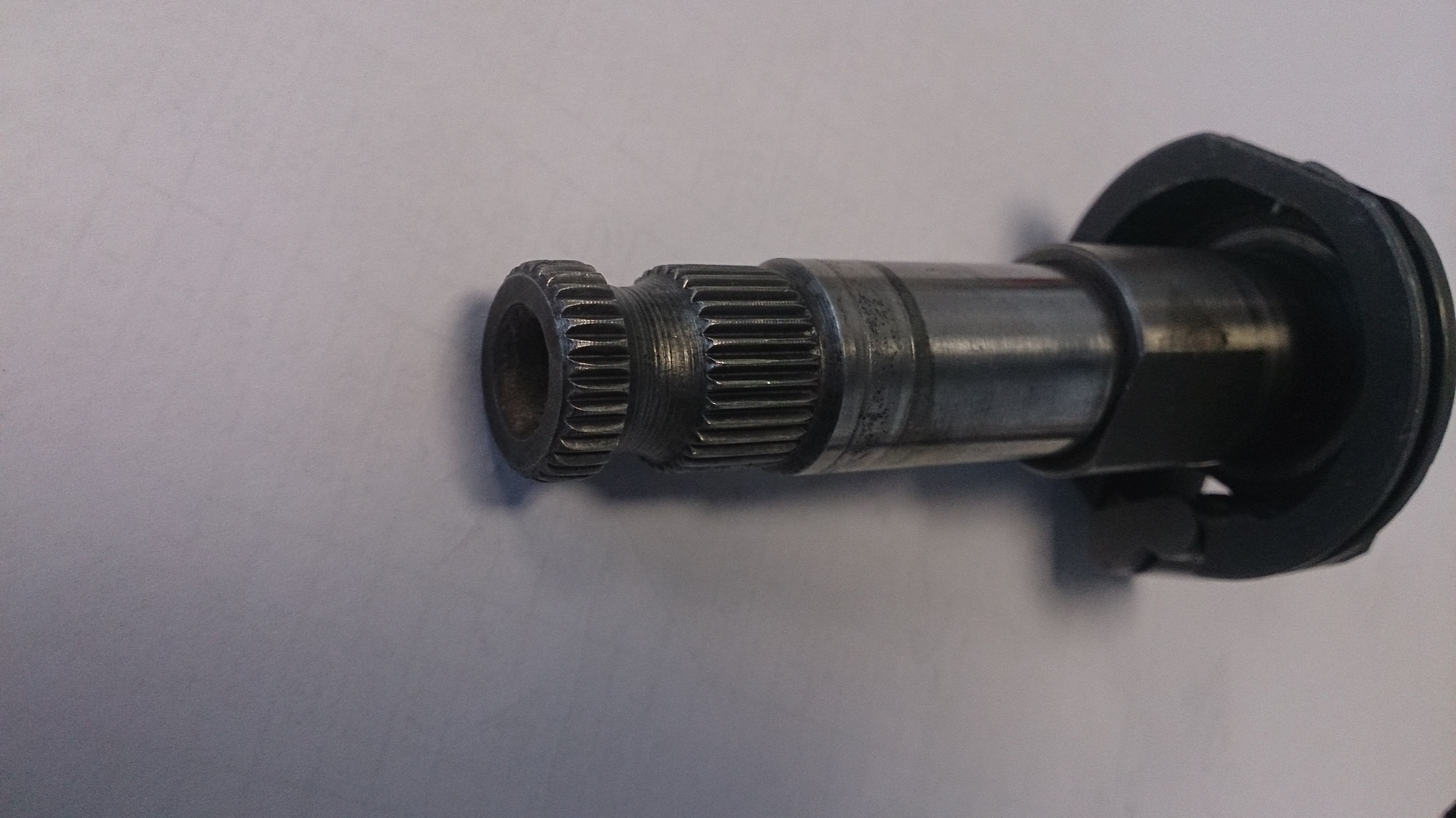

I am trying to make a knuckle to fit on this splined shaft. It is the kickstart shaft on a Honda CR250 motocross bike so it could well be a bespoke Honda spline.

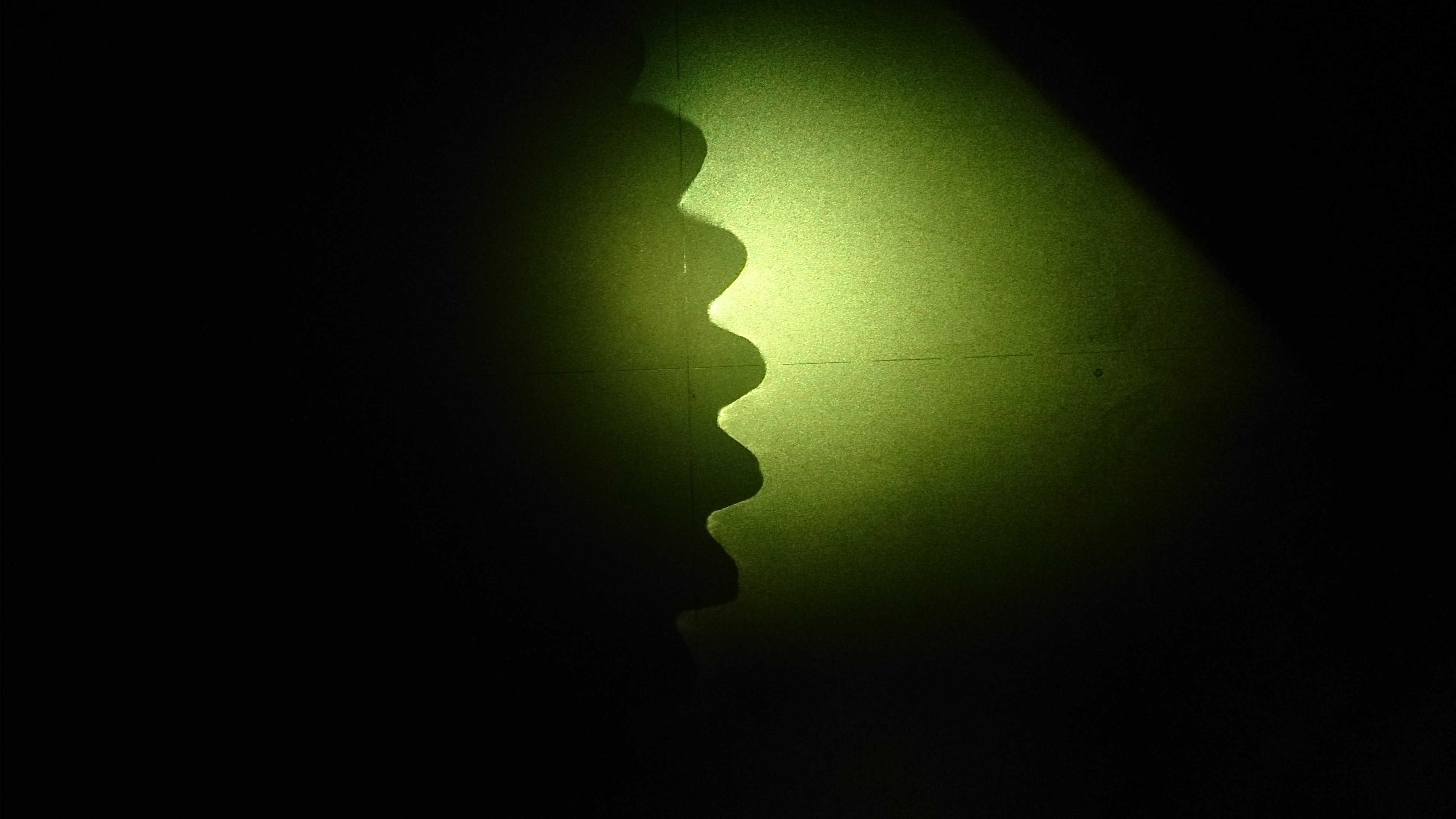

I managed to get it to show up on the shadowgraph (which surprised me as I don't know how the light managed to get past the big lump of metal attached to the shaft!) Bear in mind that the shadowgraph image may not be 100% accurate and this is a photo of a suspect shadowgraph!
There are 32 teeth and the OD is about 16.45mm but could be a worn 16.5mm. When I measured the tooth height on the shadowgraph I got 0.75mm.

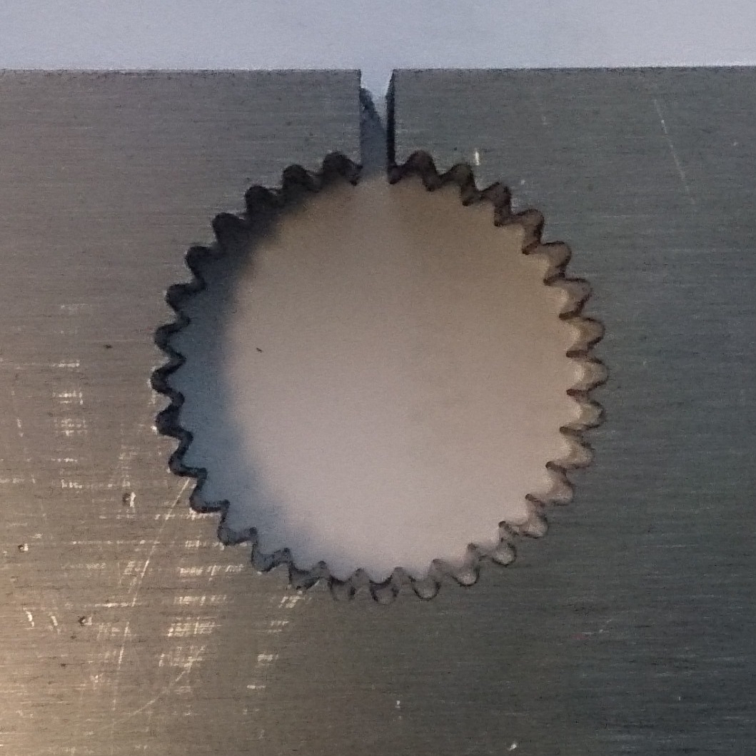

Attached is a dxf with the following layers...
1. Orig - I worked out a way to create curves from the image from the shadowgraph. Its wobbly! *
2. Gearotic - Art's spline
3. Grasshopper - a gear generated using a Grasshopper model (a plugin for Rhino)
4. Spline - made from 32 circles of radius 0.393mm on a PCD of (7.817mm)x2 to form the peaks of the teeth and 32 circles of radius 0.238mm on a PCD of (7.747mm)x2 to form the troughs between the teeth, and the tangent lines between them.
5. OffsetSpline - I offset the spline by 0.02mm which should just about give a nice fit over the original splined shaft.
Hopefully I can get this wired on the EDM tomorrow and see if it fits... I'll probably also do a couple at bigger offsets to see what works best.
Looking at the values I used in 4. above, perhaps this is a crown spline made on a PCD of (7.75mm)x2 with 0.5mm rad tops and 0.25mm rad troughs? Does anyone know of a standard that might be close to this? Or should I be looking at the angles between the tangents to match a standard pressure angle?

Ended up having to add an 0.05mm offset for it to fit but it fits OK!
