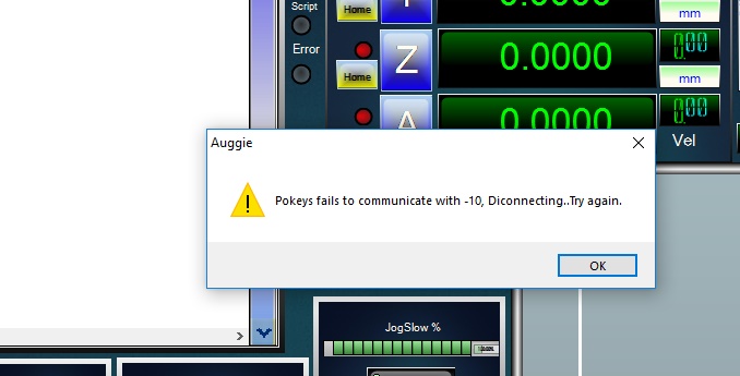

i have noticed that auggie sometimes loses comms with the pokeys when my [1/6 hp] airbrush compresser cycles off some sort of noise spike i thought, i replaced the compressor pressure sw with a solidstate relay(zero point sw) this did not cure the issue. i guess the power factor is way off unity.
The pc is a laptop the pokeys connected by usb . There is no connection to the compressor at all and it need not even be in the same room.[its not only the compressor either other things switching on /off can have same effect]
The laptop does not connect to the power ground(double insulated.there is no obvious ground point), the laser and mill are both grounded.
When i'm using mach3 and pokeys this loss of comms has not occured to date [uses same cables]
my question, is auggie over sensitive about usb comms.
or what else can i try, i just hate it when jobs stop half way through
i have not tried ethernet connection, would it be better ?

Is there any weird log error at the time, or does the reset simply trigger and resets
not sure will check, i wil try the ethernet too
when you press it? Or do you have to go through a restart or re connection?
it happens even with auggie sitting idle, i get a connection lost type message and a dialog box that allows a reconnect
it always reconnects when retry selected but the state goes into emergency stop with appropriate sound effects.
condition occurs even when pokeys is powered by usb or external plugpak.  no other usb devices on laptop are affected
what happens with auggie when a packet is lost or corrupt ? retries ?
my theory{ ahem} is that the laptop is floating above ground and that the shield in the usb cable tries to reference the laptop to gnd
when there is a sufficiently good sized transient on the mains (utility ) power it introduces noise into the usb stream.
modern laptops have nothing easy to wire a ground point to , i have two laptops both do the same thing

i have had it running for a hour so on in ethernet with no dropouts.
better still i wired an earth directly onto the pokeys ground pin and now everything seems happy
it was coming via the laser.  i will try this for a while ,my new laser won't have an ethernet option
and the pokeys57u has no external power option either so i need to sort this out.

Theres a few reasons a disconnect can be triggered, does the error say
"Disconnect on input"? Can you tell me the message as closely as you can?
Thx
Art

it ran all day with compressor cycling every 5 minutes , 1 dropout

i did a bit more testing today with the  PoKeys57U and it looks like a noise spike can and is resetting the pokeys (laptop makes dah dong usb sound)
the PoKeys57U is not made for an external power supply . i will wait till i get the extender and see if can feed 5v into that .
if the pokeys is resetting auggie can't do much about that

  You know, the only tiem I recall such a symptom is when the power supply for
the pokeys wasnt enough current for it. I recall that in a K40 machine, the pokeys
reset at odd times, turns out my 1 amp 5v supply wasnt near enough.
