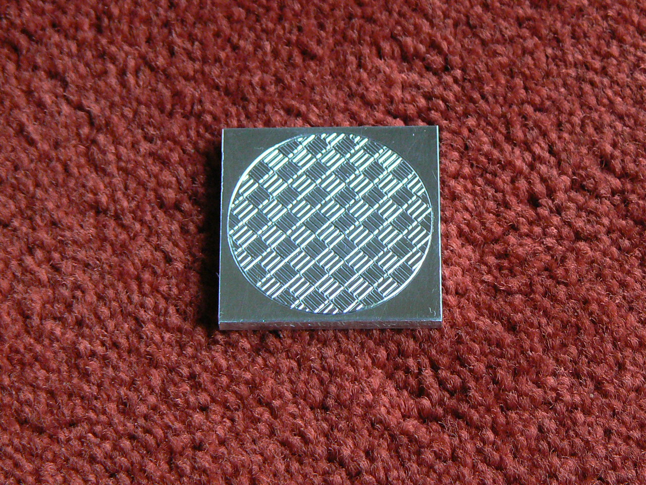

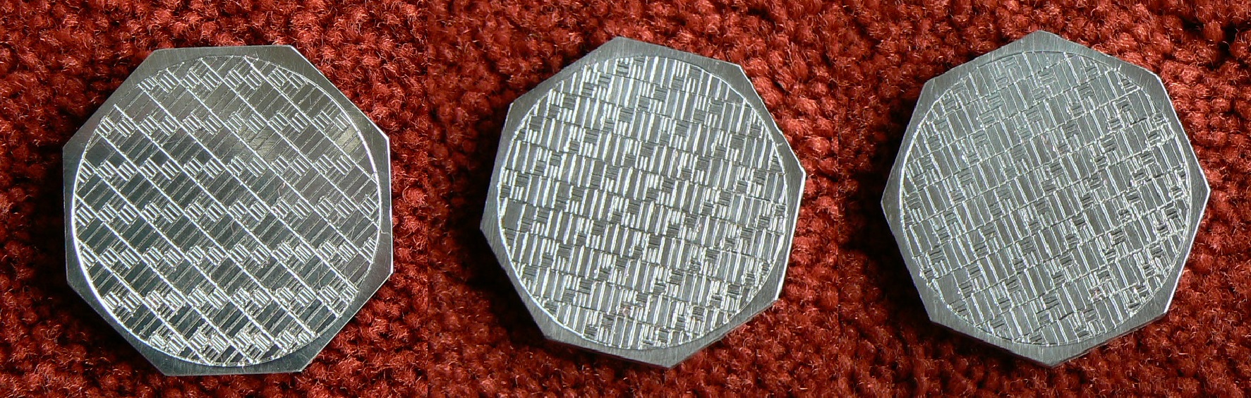

Inspired lately by the guilloch? messages from Mooslake (Kirk) I did a few other trials.
If I did saw well this week, Kirk posted a message in another subforum here, so I hope there is some form of recovery from the latest medical procedure.
In that case.... it's time for a few pictures.
First the "basket weave pattern", well known.
But in a video here above we saw that master engraver/horologist Joshua Shapiro, made a variant on the basket weave:
Some baskets .. are left empty in first instance, but later.. filled with an even smaller basket weave pattern.
So a basket weave within a basket weave.
Time for some amateuristic imitations....:-).
In the second photo the circle (about 30 mm) is only rotated a few times, to show in all three the same object, but only with that rotation
(to show different looking patterns, ONLY due to the position of the light).
Hessel
