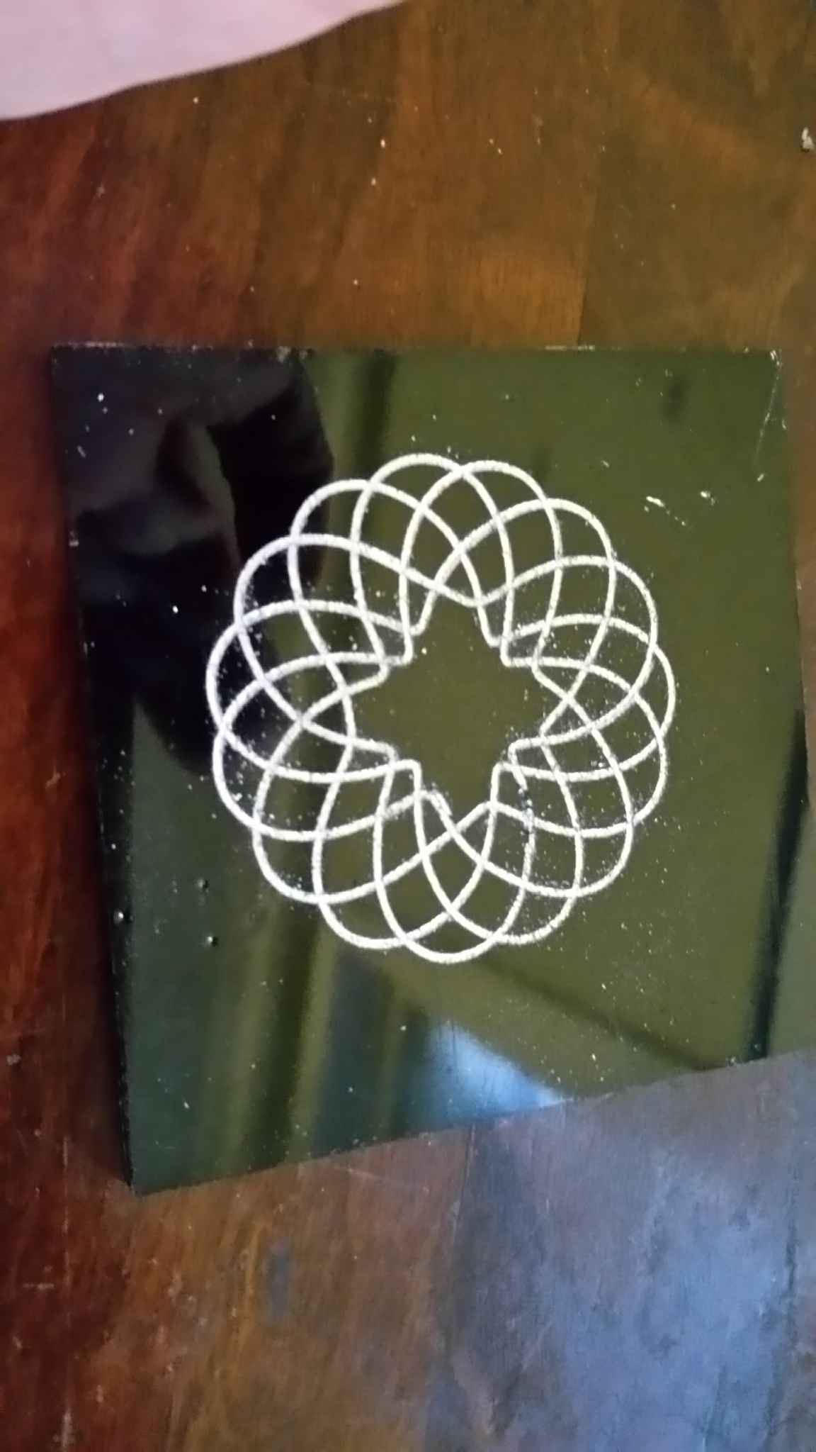

i just tried a guiloche on a scrap piece of flammable building cladding .
[platicised rocket fuel sandwiched between two aluminium sheet with a uv plastic exterior coating, think granville tower]
might be a better use for the stuff other than making high rise roman candles.
this scrap was a bit damaged and the camera flash shows every defect nicely
made with aforementioned springy engraver tool [3040 mill @20000 rpm 1000 mm/minute]
needed a couple of passes due to surface dints. the edges have very little burring

That looks great!
Is that the aluminum/plastic/aluminum sandwich board the signmakers like. I've seen it sold as omega sandwich board, and it goes by other names. Another version, alumilite (sp?) has a corrugated core and might make a better rocket fuel. Nophead's Mendel90 3D printer used it as a frame. I got quite a lot of it as scrap from a couple sign shops, with a solid (what looks like) polyethylene) core and it cut very nicely on my ZenBot mini; made a set of gearotic gears with it and planned more before the 3D printer obsession intervened.

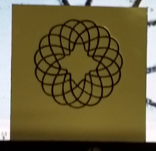

that was the first time i have experimented with it , my first thought was wow this stuff would be excellent for signs/instrument panels etcIs that the aluminum/plastic/aluminum sandwich board the signmakers like.
so it probably the same stuff.
just need to figure a way to remove the al chips [caustic bath may work]
i have had it for several years it was the ball screw version , since upgraded to usb,vfd spindle. pokeysRichard, how do you like that 3040? Is it the parallel port or USB version?
as it was delivered the x axis was not parallel to the table ,it needed some work to true it up.
the z axis is now showing some backlash that will need attention. overall its held up well and made lots of chips
i dug in a bit deeper here completely through al layer

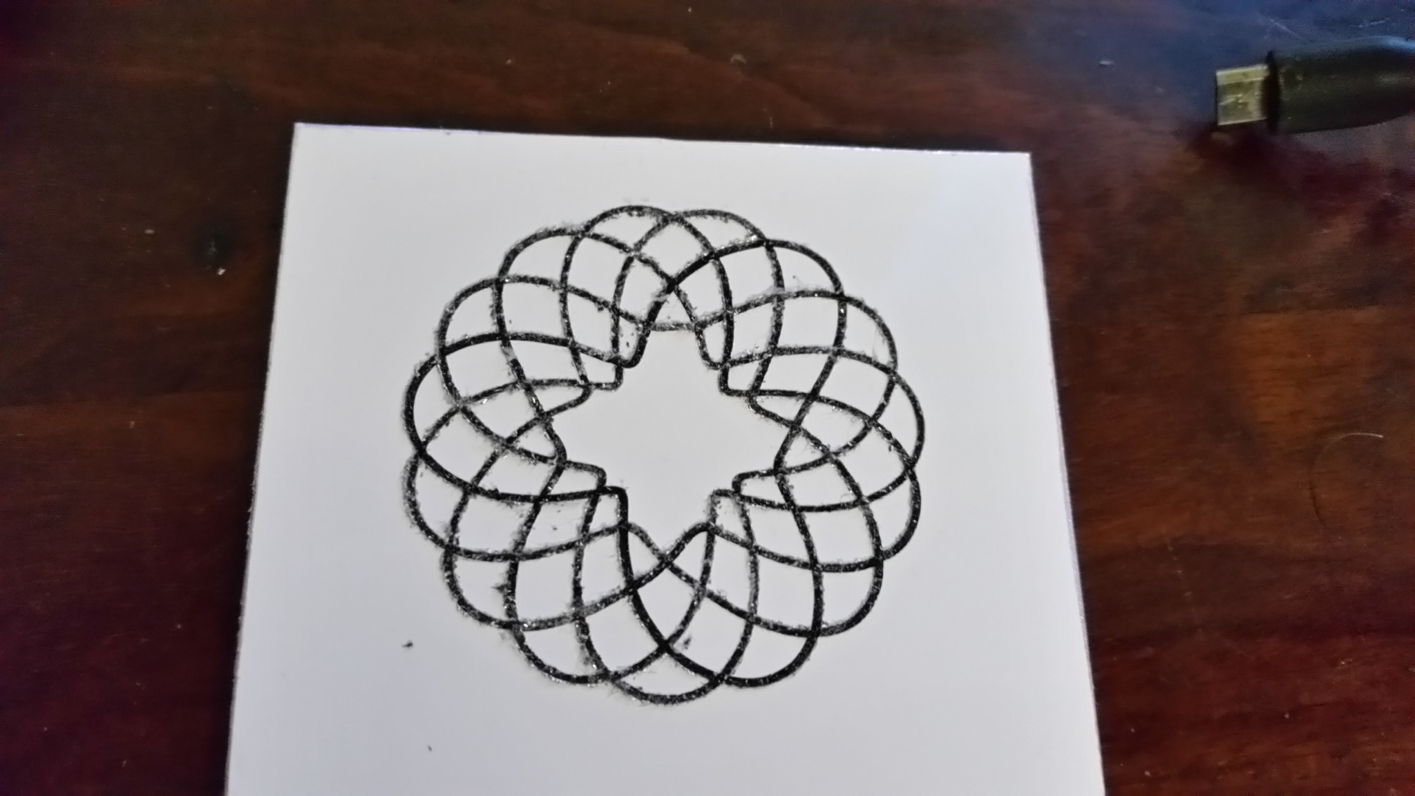

My 3018 also has an extruded aluminum table, it was out of level about 0.3mm and a little dippy too. I double side taped down 1/4"/6mm mdf and surfaced it in 0.1mm steps until it just skimmed the whole table. I'm concerned about moisture in this damp tropical climate but so far it's held OK. I'm doing 0.1 and 0.05mm cuts without problem. In the first picture the ds tape wasn't all the way under one side and the sheet must have dropped down a little, but since then it's been nice and even. I started off at a higher speed, think it was around 300mm/minute, but since slowing down to 100 it's been cutting a lot cleaner. This spindle is only 7000 rpm with a one flute bit, perhaps the 2 fluter will go faster. I keep telling myself that with all the screw turning, clicking, and multiple narrow passes it's far slower on a rose engine.

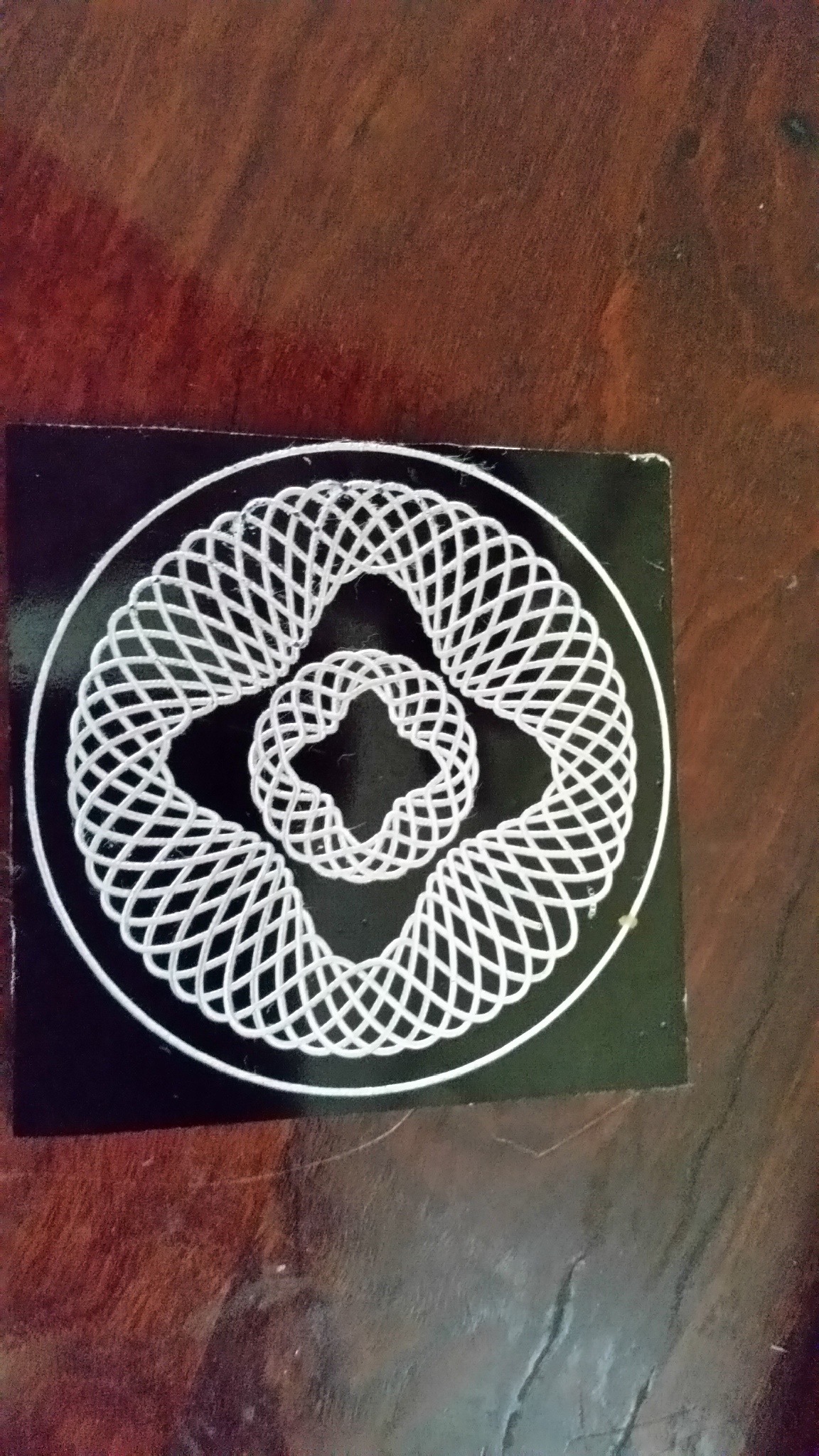

I'm going for the shallow engraved style, going to try closer together tomorrow with the 90 degree bit. Maybe if I'm really lucky I can get a barleycorn effect but that might be dreaming. I've seen pictures of the same pattern both v cut and done with a diamond drag, and while I like the diamond bit think that v cutting is closer to the historic appearance. Those old machines could use asymmetric bits with different angles on each side, but that's going to be harder to do. Grinding bits out of drill rod so they swivel in the spindle might be getting too carried away, particularly when there's lots of basics to sort out first. Plus no drill rod, or grinder, or way to harden it down here.
I like the black background against the top layer in yours! It took me a while for your rocket fuel comment to register. Things that look great in the lab don't always work out in real life, sometimes with tragic results.

this one shows the issue with my setup , @the 4 oclock position
not sure if the missed cut is z backlash,or the bit stuck up the holder or something else
- Posts: 152
Re: Guilloche!
forgot to add
i fount the high angle bits >45 deg create more burring than the low angle bits , 10 deg break too easy ,30 is my fav
i just get cheap ones and expect to much i think
