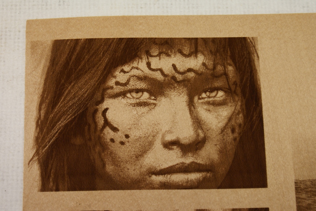

My adventures with Auggie.
I am a little disappointed with the performance of my electromagnet, particularly after Art has spent time at my request increasing the available PRF range of the PWM signal. I was expecting to get up to 80Hz response from my magnet but have found 50Hz to be the limit and even then I have to reduce the travel to 0.5mm which does not give my expected weight to the impact. Reducing the PRF to 40Hz will allow me 1mm of travel and possibly sufficient weight to the impact but the feed-rate needs to be reduced to about 500mm/min., which is painfully slow. Unfortunately everything is a compromise.
In the light of this experience I am going to re-design my electromagnet ? I have a couple of different ideas in mind and it will be interesting to try different designs against each other and hopefully find the optimum.
In the meantime I am back to using the laser and I am just so impressed with the performance of Auggie and all the various effects that can be so easily produced.
I have to say thats one of the best photo engravings Ive seen in terms of texture and color
blend. Nicely done.

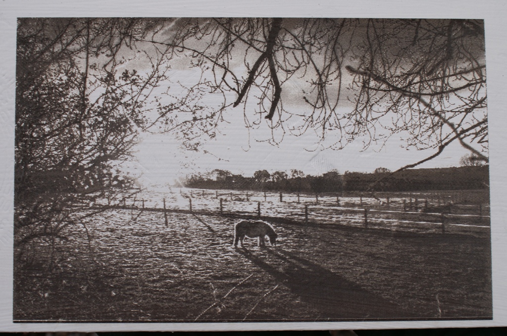

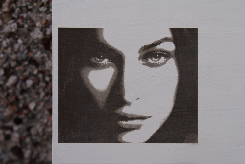

This is just a scrap piece of ply which has been painted white. Interesting that this paint has just two tones (plus the base white). Does all white paint have just two (or perhaps 3) tones I wonder ?
I get the same results from white melamine coated chipboard. I suspect its
a type of plastic that's in most paints and seems to go from white to charred
very quickly.
You can see in a grey scale print that it actually can do a range of about 5 steps
in my tests that are readily identifiable. Not much range compared to raw wood.
very quickly.

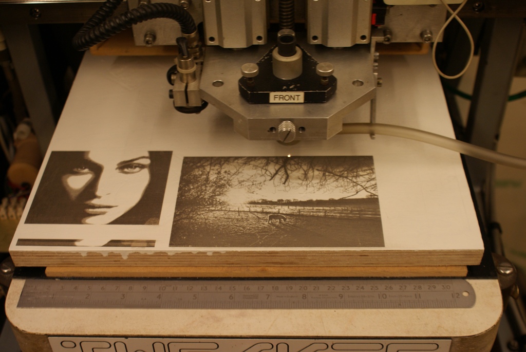

I am really not quite sure why anyone would want to laser engrave a photographic image onto a piece of wood in the first place but, trust me, once bitten it does become addictive.
I have, over the years, used many different software?s for laser control and image reproduction and now that I am getting to grips with it I can honestly say that Auggie is by far the best I have ever used.
