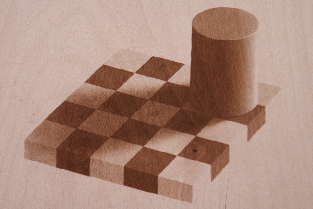

That would be a shame because it would rule out 1 bit images that have not been dithered being re-produced with an electromagnet.

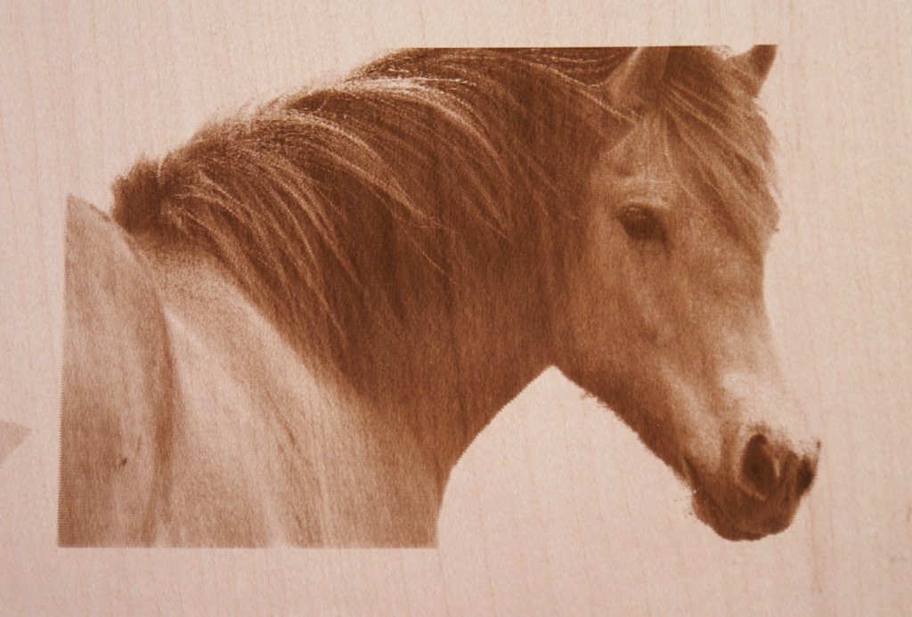

In the meantime another 8 bit image laser produced.
That works really well. )

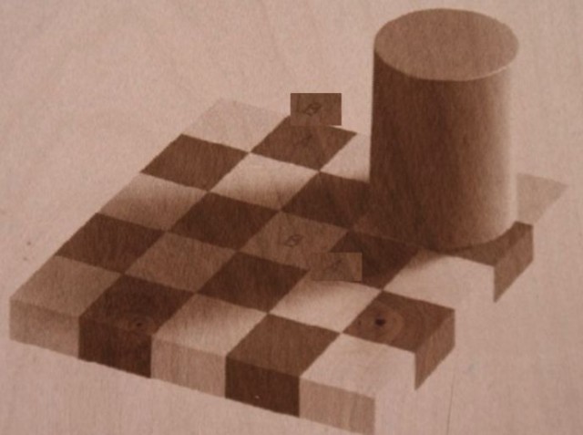

I was not sure if this could be reproduced using Auggie but it is one of the finest optical illusions of all time. Perhaps hard to see the letters but the two squares marked A & B are exactly the same shade of grey.
This video provides a demonstration; https://www.youtube.com/watch?v=z9Sen1H ... e=youtu.be
Good question, Ill have to think about that one .. Id think
linearity would be very important..
Once you get into this 8 bit image reproduction it is really hard to know when to stop. I suppose running out of wood would do it but that?s not going to happen any time soon ;D

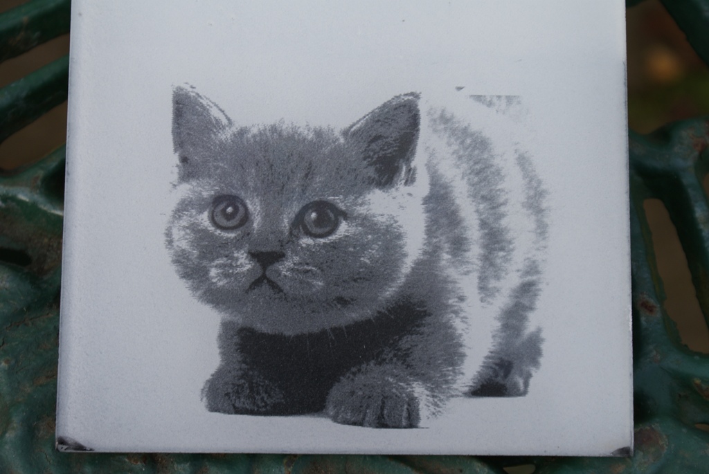

Glass is a 1 bit material so 8 bit images are usually reduced to 1 bit and dithered (to create the illusion of shade) but there are alternatives. Paint is not a 1 bit material so painting the glass then lasering an 8 bit image on the paint produces some interesting results.
In this example the paint and image have been done on the rear of the glass.
Amazing how the horse looks almost to be in color..
I did a similar one to the cat on the back of a mirror as a test.
Worked out pretty good at the time.

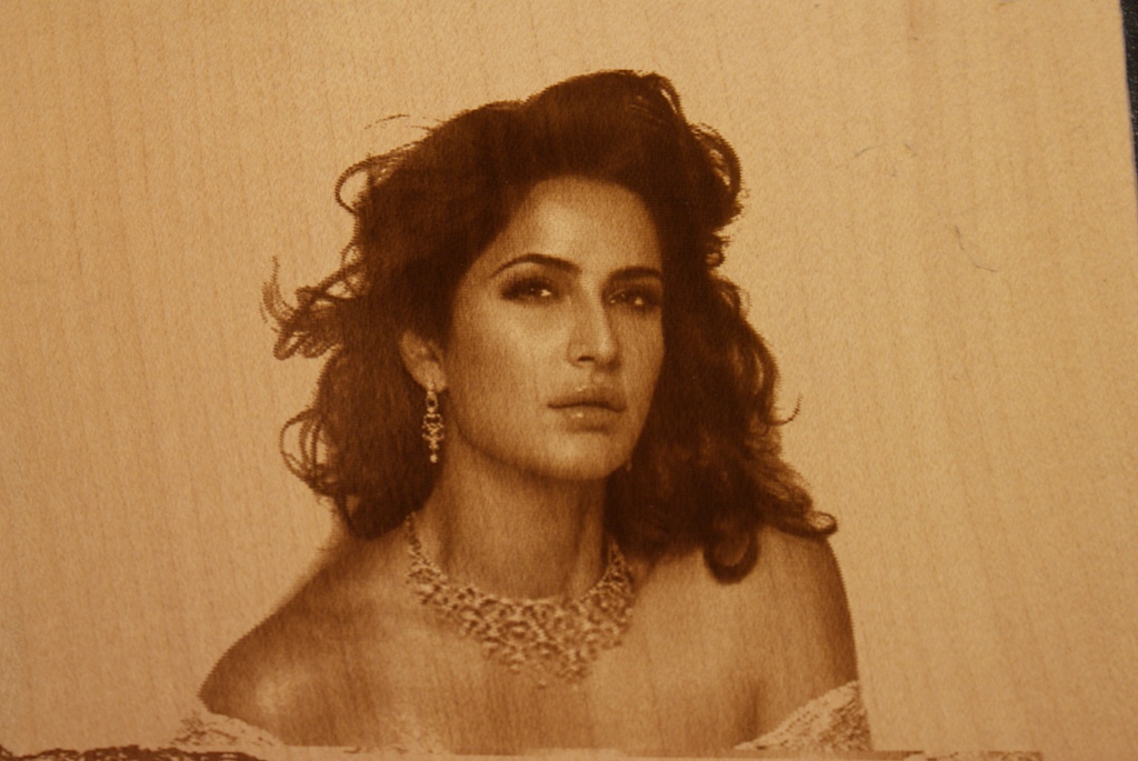

I have just been sent this picture by a good friend of mine in Hungary. He has copied a section of the A square and pasted it by the B square and done a similar thing with the B and A squares to prove that the shades of the two squares are indeed the same.
Looks like we are both impressed with Auggie?s ability to allow shades to be laser reproduced with such accuracy.
