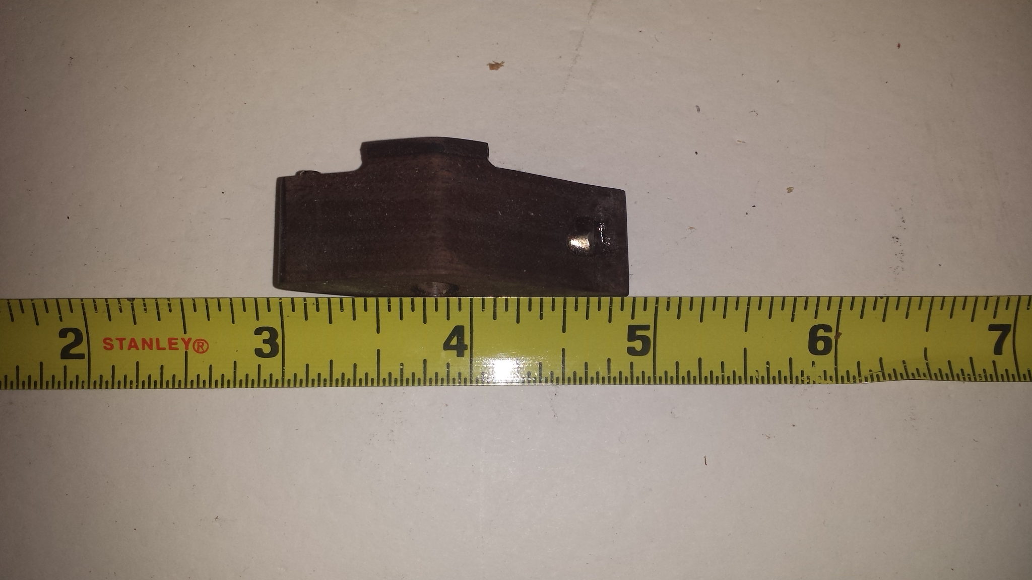

Is there one or two magnets in the piece in the photo?
Also, is there some type of counter weight added to one
side of this toggle?
Richard
Richard
Re: Orange Clockwork Ticker
Hi Rocket:
The toggle has two magnets. The first is a very small 1/8" round magnet planter in the top back corner facing upwards,
it faces a mate in the top that is at the "rest" position of the toggle. Look at the top photo and youll see a post.. ( cut from a
Q-Tip cotton swab, that post stops the toggle from swinging its back end out further, and also defines the "Rest" position.
At that spot is a small 1/8" magnet that attracts the 1/8" in the toggles top facing upwards. All these two do is define a
very weak spring that holds the toggle in its rest position as it swings around CW. If it was out and hit a post while moving CW,
the toggle will get flicked back to hit the cotton swap post, and the magnets will then attract each other and hold it there.
The other, and more important magnet, is a cylindrical magnet, 1/4" by 1/2" inch long that is embedded into a groove
cut into the toggle, it faces outwards so as to attract itself to the cylindrical magnet in the trigger latch. As its hard to determine
where this magnet goes in the toggle, the one in the trigger latch is pressed further away or closer to the one in the toggle
to adjust their relative power to attract each other. SO to put the one in the toggle, tou have to machine out a groove to fit
the cylinder into, or, if you use a different type of magnet ( any will do) , drill a hole or make a pocket, whatever it takes
to attach a magnet to the toggle strong enough to pull itself toward the trigger latch as the top turns CCW toward it.
