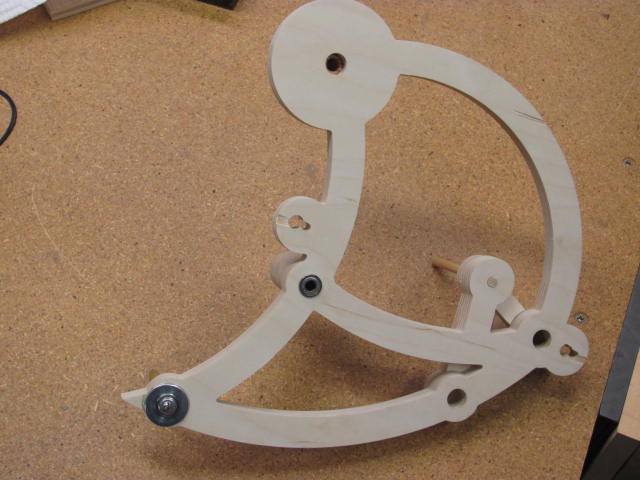

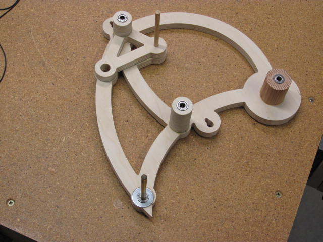

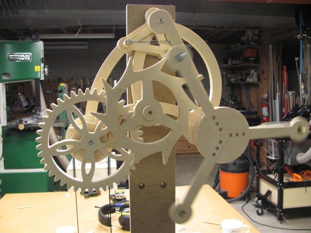

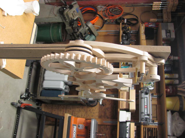

I finally got around to building Scimitar. I used flanged bearings in the frame so the entire shaft moves instead of using a fixed shaft with bearings on the individual components. I goofed up by not building an extended arbor at the weight location so I machined and epoxied on a couple of steel fender washers to manage the downward force. It actually works pretty good and keeps the weight spool close to the frame. I'm waiting for another shipment of bearings to mount the vanes. There is no finish on the plywood because I wanted to build Scimitar as a learning tool rather than wall art. My comment to anyone building this project is to add extra set screws to the vane shaft components because the ratchet impulse is rather violent and can easily change the timing if not tightly secured.

Thanks Bob, I don't know why the last photo was sideways. Is there a way to correct that when uploading?

Learned about timing, balance, bearings, shafting, shaft supports, recoil chronometer escapement tuning and placement of components using spacers. All that from this one little project!
Thanks Art!
