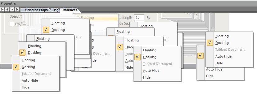

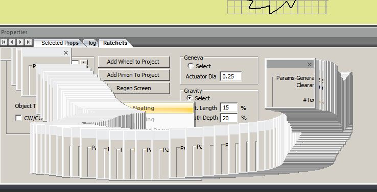

Some kind of issue with the floating and docking

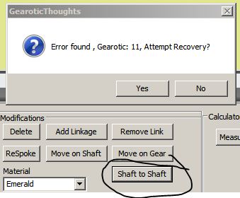

and the shaft to shaft button pressed gives an error

Ya:  Sorry for that error, I havent had it as yet, but Ill add some safeties in there. Its young and sensitive to how its used,
  I imagine Ill just have to add some safeties when I fiond what type of combinations create the error.  As to the docking, Ill
list it for investigation, I never undock so I havent as yet discovered its limits.
