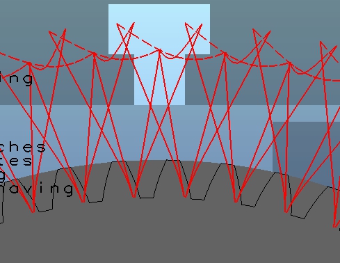

Couple things.
Tool change is still in the output.  :)
The tool path is still off for my test 63 tooth gear.  (See screenshot)

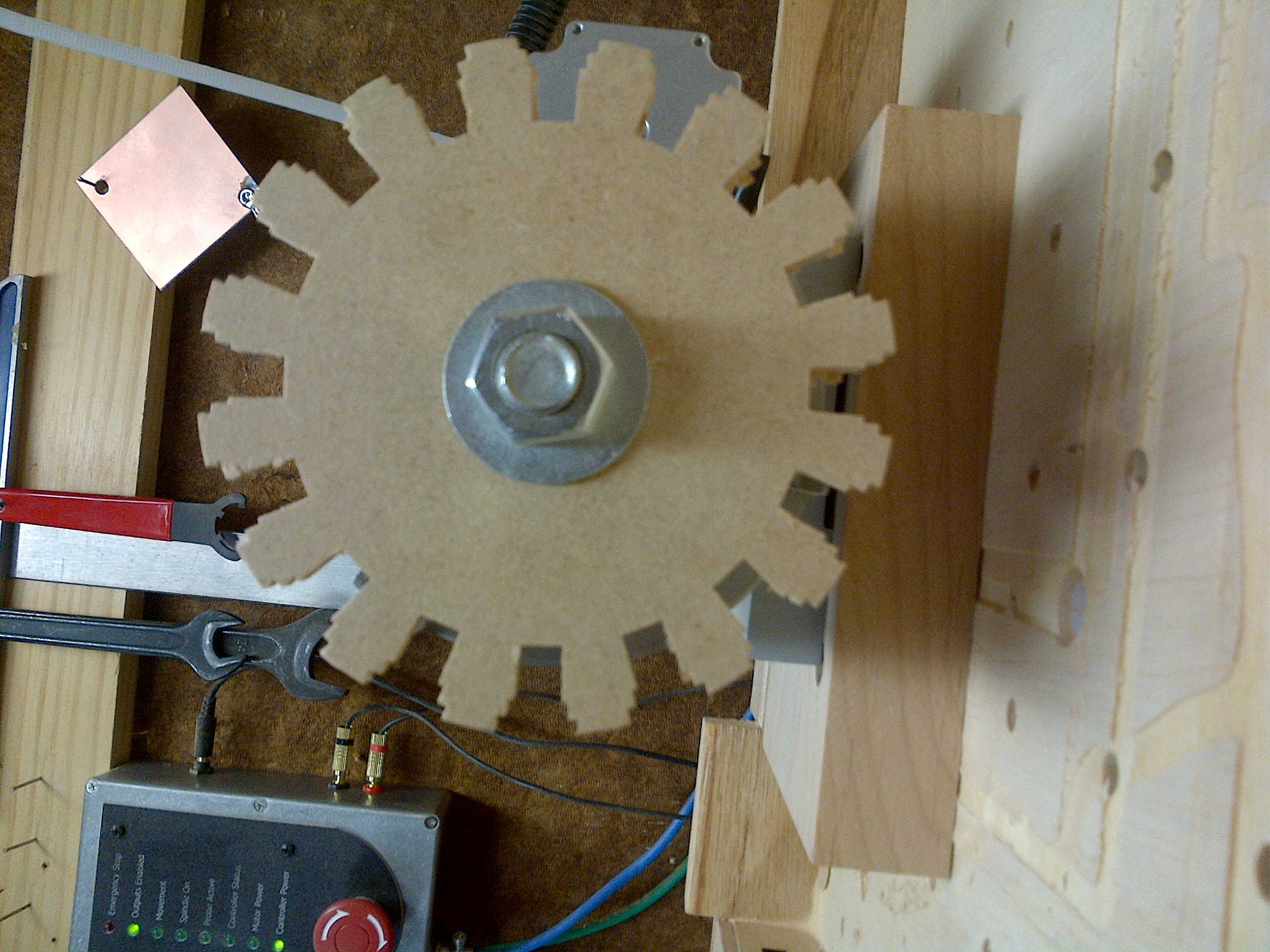

1.05 Test Cuts
Post by SkyMoBot »
I did a rough cut of the same gear from last time and I see the difference.
It did take forever to make that last cut at the bottom of each tooth.  A feedrate of 60 for the A-Axis means it takes 6 minutes to do a full rotation.  Maybe the A rotation could be at rapid.  Nitpicky, I know.

Re: New Version released.
Sky:
  Thx for that test, they do look better. It was your original display that drove me to add the radial cuts..I knew they had to go in at some point. :)
Ill look into the time on the bottom level...
