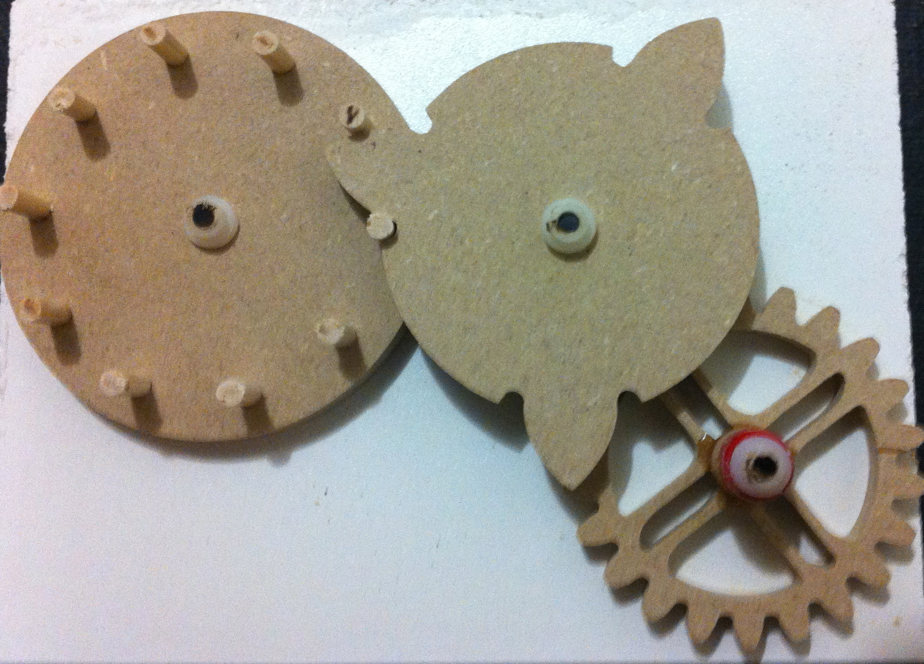

The geneva's are inverted geneva's with a rythmic capability. This means that unlike the maltese cross
geneva's, they use the standard lantern gears to function. They can be cut without pocketing or double
layering of the shapes involved. They will very much look like a standard lantern gear set with some important
differences. Youll find them on the lantern gear tab. Checking the box for a "rythmic geneva" will activate them.
Youll notice you get one tooth that performs as a geneva, but the button beside the checkbox allows you to add
teeth by simply clicking on the spur gears tooth location.
A geneva usually pulses the driven gear by a set amount per rotation,
the GM version allows you to have several sets of pulses of various widths.
Take note that the amount of rotation is a bit non-intuitive. Take for example,
two gears that are both 10 teeth. 10 pins on the cage, and 10 pins on the spur.
This is easy to figure the ratio from, its obviously a 1:1 rotation. But what
if the cage has 10 pins and the spur has 1 tooth. Whats the ratio? If you said
1:10, youd be wrong. One tooth of a geneva will move its mate by 2 teeth.
This means a 10 tooth to a 1 tooth will have a 5:1 ratio.
Each impulse tooth overlaps the next tooth so it can be difficult to figure
by looking what the ratio is till you play with it enough to understand that
relationship. Youll understand that as you play with them so I wont dwell on it. :)

The spokes that do generate only appear on the Geneva component - and not the lantern - was that intentional?
Re: Version 4.85
Yes, the disks on the pinwheels have never had spokes, they are generated on the fly to simply match the size of the pins, which are the only real objects being made. The lantern gears are really one of the weirder gears internally as they arent so much an actual object as a construction assembly made up of primitives. I may look at spoking them eventually but
its normal at the moment that they have no spokes.
