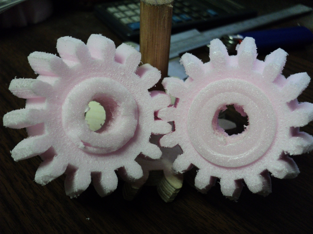

 I managed today to cut my second good bevel, a match for the first and they run perfectly together. ( Of course they ARE styrofoam), but they dont take any pressure and you cannot feel any binding in the roll.
I had a lot of trouble getting to this point. Much of it was my own misunderstanding or wrong assumptions on the math required. Turns out the process is fairly easy, but any wrongheadedness in cutting can make you think your wrong in many ways. As a result I ran down many wrong alleys.

 Let me know if you do a test, I need to see the result if you can photo it, if not please let me know how it runs or anything you note in the process.
