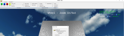

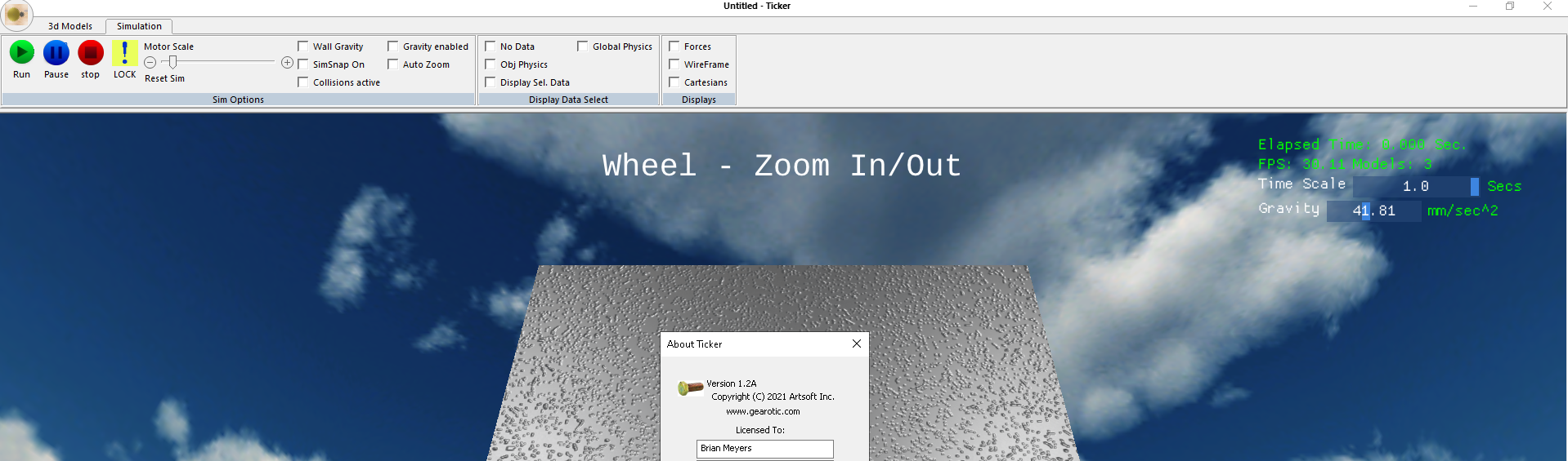

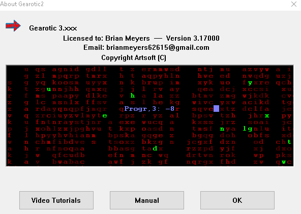

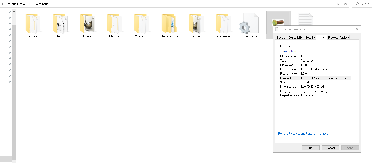

and installed to c: just to see (my regular location for gearotic is d:). no joy (ticker.exe date stamped 2022-12) and then deleted the old from d:, and (re)installed there ... no joy. deleted ticker subfolder and reinstalled. :-(
disabled all the add-ons in firefox. haven't been getting any error or flag that system prevented overwriting.
still must be something to do with my computer. and particularly odd symptom -- not up to date on programming ins and outs but wondering how msi can be "merely" copying and yet copy old exe.
just in case, i've attached versions screenshots of Vexx and Gearotic.
123MB (according to the download status bar - and 122MB on the details tab on properties (presume that's logical file size); and, 128[,649,728] according to properties tab (presuming that's physical file size).
[/quote]
Re: Ticker 2.0Beta release.
Brian:
The one I download is 135M in size, so your definitely downloading an old version. I wonder if a cache server somewhere is serving it to you
or something, its very mysterious. Can you try another browser, like Chrome or Edge. I think your browser may be stuck with a file in its cache
and wont release it, so it simply feeds you an old copy. Clearing your cache should fix that, but another browser should work right away.
Let me know what it does, if it continues, Ill make a copy on the site with another name for you to try (that you couldn't have cached.)
