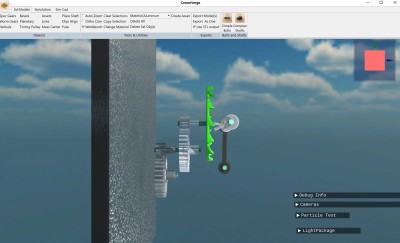

I include a couple of snapshots of what the above describes. The first ( sim) shows a
virge type escapent shown in perspective from the side, done by clicking the side
box on the top right. The second shows what you then see if you select the CAD button
and a drawing being added in context to the mechanism for rapid extrusion to that
plane for placement. The blueprint feature I am finding is very handy to quickly
