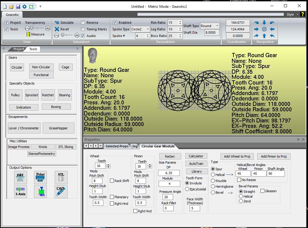

Re: Release Jan18th 2018 --- Problem with Involute Gears
Post by Pezwiau »
Dear all,
I have problem in creating an involute gear with the latest version 3.03.
Please have a look at attached screenshot.
Can somebody give me a hint what to do?
Best regards --- Peter
Hi Peter:
  Set your pitch shift back to zero. It should normally be zero on both gears.
