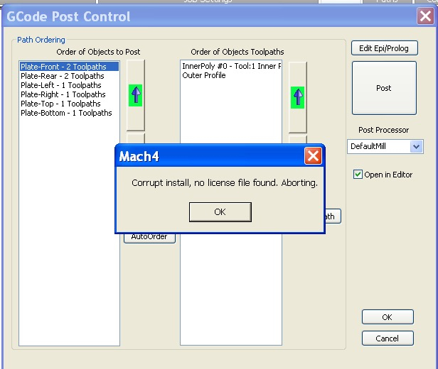

Here's what I have - this happens as soon as I try and name the file and save it.

If you uncheck "open in editor" do you still get that error? Do you have by any chance, Mach4 set up
as your editor in the settings? If so, please remove it and set a text editor to that setting. I suspect its trying
to open Mach4 as its editor.. and Mach4 wont allow that..

That unchecking of the editor did the trick - I no longer get the error message. For some reason my program defaults to that box being checked each time I go to save the paths. Something I'll have to remember

The error is actually from Mach4, its because in settings you told the program that Mach4 is your editor.. just set the editor
to an actual program that can edit GCode, like wordpad , or Mach4's Gcode editor..
